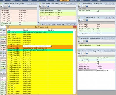

I've configured a 4.9 sensor and have a second wideband with external controller on Analog 2, now it show me it as double entry in the "input assignment" .
Also i'v tested it and it don't read the primary wideband sensor correctly, it show 14:7 in free air, tomorrow i'll double check the wiring and switch to another 4.9 sensor just to be sure.
