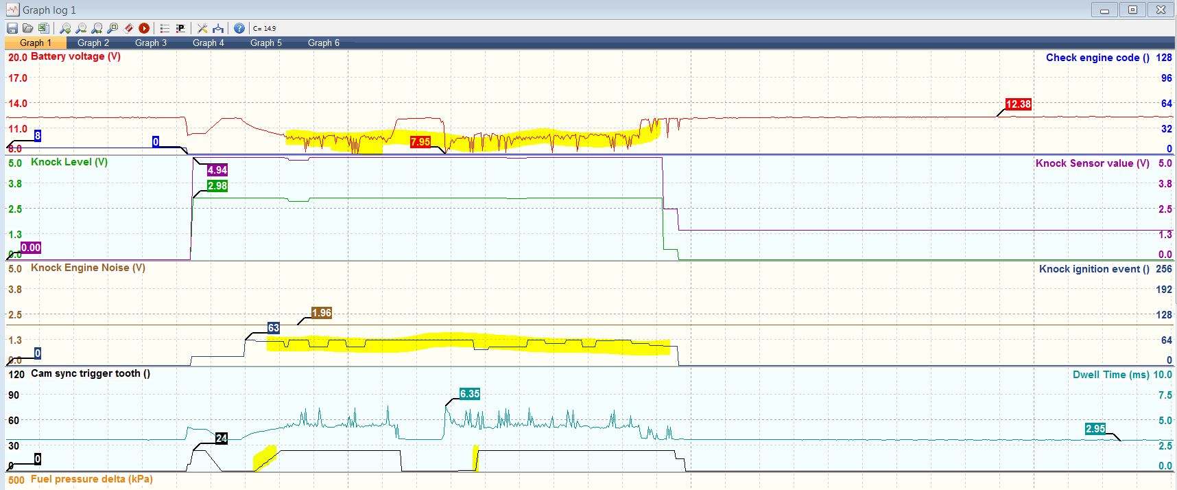

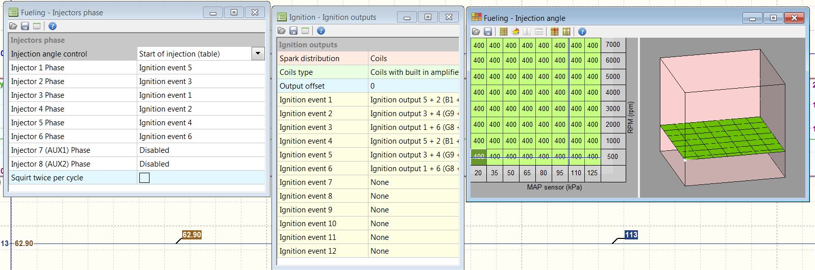

1) Ignition output #5 is incorrect, change to 3&4...wasted spark is the same pairing to event #2.
2) Ignition is locked to 0 deg....change to 10deg and check with timing light
3) Log shows battery voltage low and irradic. Is it a fully charged battery?
4) Turn off Knock *temporarily* until it starts good. Knock Ignition Events shows knock events on all cylinders. Are you using flat response 2wire sensors of the OEM?
4) Scope looks perfect, settings and edges correct. Log shows that the trigger is synchronized, but the cam sync tooth is still climbing, before it its stable at 24. try lowering secondary trigger/disable camsync above to: 2000rpm.

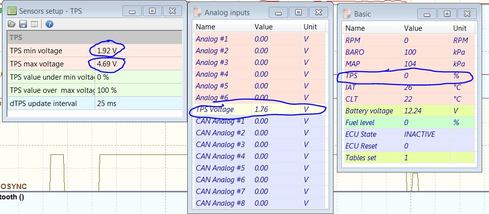

7) Your TPS min voltage doesn't look right, typically its near 0.6-0.8volts....use this attached pic to calibrate your TPS. At 0% throttle, read TPS Voltage, set that as TPS MIN...at 100%, read TPS voltage, set that as TPS MAX

1) I fixed the ignition event for ignition output #5.

7) I had also noticed the TPS min voltage to be really high, I have calibrated and lowered it to 1.74V but that still seems high to me. I am going to rewire it so see if i can get it to come down.

I have rewired the TPS and re calibrated it.. Now the min volt is .87 and the max is 3.8.

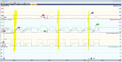

Re: 7MGTE No fire - Can someone take a look at my calibration
sadly the oem knock sensors wont work with emu, so thats whats going on there...glad you got that tps right, that was pretty strange...the battery noise would
be the next thing i would dig into; all those spikes are affecting coils, injectors, wbo, etc and it will never run (i'm going through this same issue on a mkiii now...and finally got the owner to ditch the pnp and do a new harness) I'll look at the new log tomorrow, and see if i notice anything else...
it would be great if others would start to chime in here...it seems like i get little/no help with my issues too

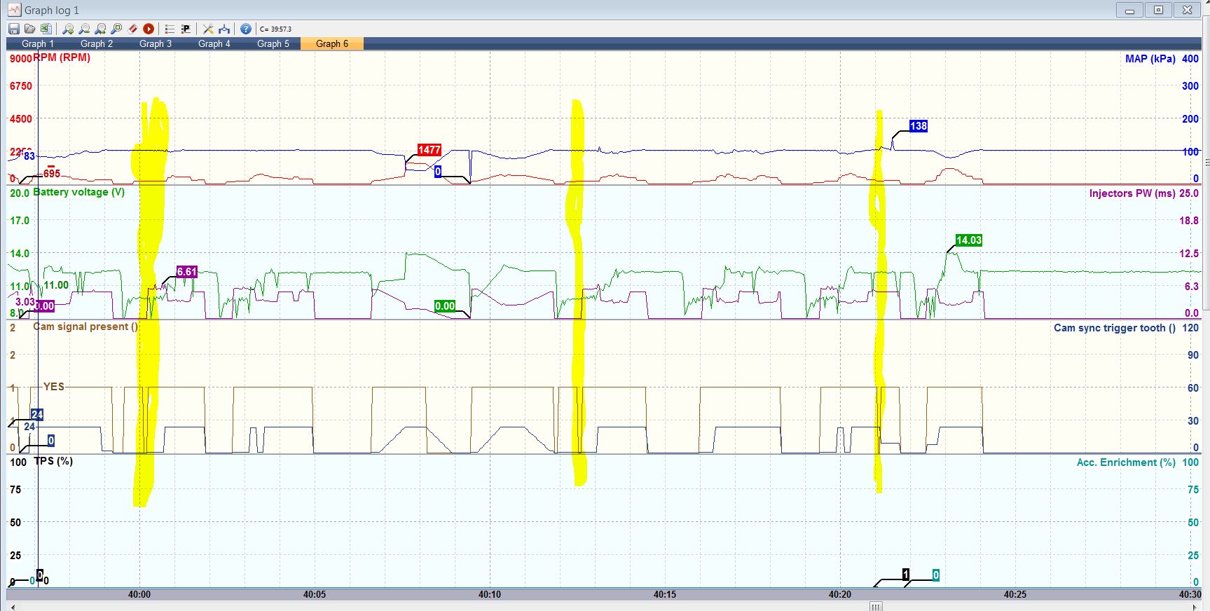

I'm not entirely sure which cam sensor you are using but try ignition order 5,3,6,2,4,1 and injector order the same. use the "start of injection table" and the table should all be set to 400deg.

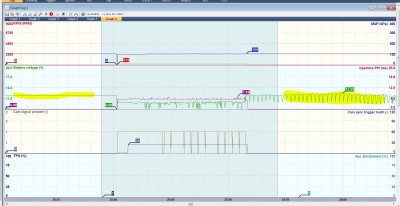

you have some serious issues with Battery voltage. Could be battery, alternator, poor power cables, poor grounding....the voltage is pretty flat, when the ignition is on, so battery might be okay.
There are a few sections there that the motor was turning 200rpm, had cam sync, then lost it momentarily.
Try 4.7K pulldown resistor on primary, and 4.7K pulldown on secondary. <---I have not had much luck with this, I had to physically add 20K primary and 10K on secondary on my car. The PNP adapters also have 10K builtin.
Here is a good snapshot of your log. at 25:40....it shows battery voltage was a beautiful flat line....you tried cranking it, and cam signal is loosing sync (*add a resistor to help with that noise)....but afterwards, battery voltage is erratic.

Just for anyone who is reading/ following this.
Figured out the battery voltage problem, the ECU 12v+ supply was connected the the 12V of the ignition and not the 12V battery wire, This however does not negate the fact that the ignition circuit still has fluctuations in it. I verified from other 12V sources that this issue is isolated to the ignition Circuit.
I have the car up and ruining ( sort of ) now. When I first got it up and running it was surging extremity bad going from 900 to 2000 rpm, this was because it was hitting decel fuel cut. After correcting that for the time being i have it idling in a safe AFR now, but currently the issue is that the idle is at 2000 rpm and no matter what i change to the IACV in any of the idle tables i don't see any changes past about 1800 RPM. I have verified there are no vacuum leaks and that the IACV is operational and the wiring it correct. There has to be something in the software that i am missing that is doing this.
