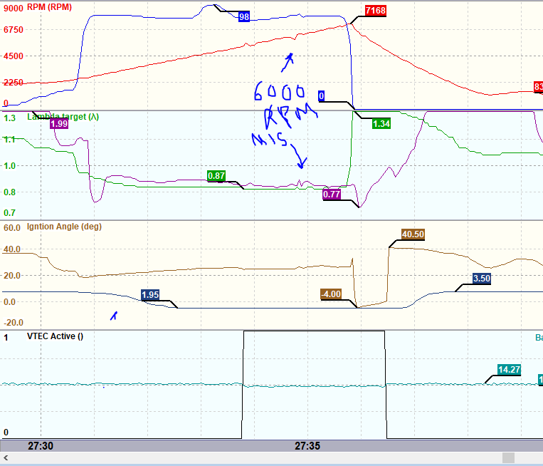

Got back to driving the car today and there is still a bad misfire at 6000rpm. It seems to come and go which is really hard to diagnose.
I've attached the log if anyone has any ideas. Here is a screenshot of the spot.

Post by valsorimkaran » Mon Jan 07, 2019 5:52 pm
As far as I can see, your problem is in the Cam sync trigger, from 24 to 3.Image

Post by BillyC » Thu Jan 10, 2019 8:06 pm
Thanks for taking the time to check that out! It seems obvious now and I should have suspected that. The Honda distributors are notorious for wobbling at high speeds. I'm sure noise could be the problem as well. ECUmaster tech support also replied with some recommendations on how to solve the issues. They are very responsive and helpful every time I send them an email.
Tech support recommended turning off camsync above 4000RPM. As far as I can tell it was a great fix and the car runs perfectly now. I'll upload the new tune to forum once I have it dialed in a bit better. Now that it's getting colder here I've had an opportunity to dial in cold start and warm-up more.
