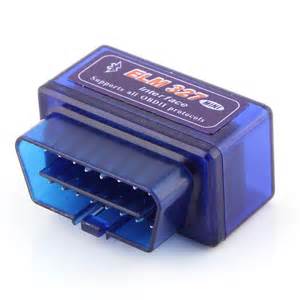

Would a conventional OBD-II CAN plug using bluetooth of wifi(such as ELM237) work with EMU black If I connect can+ can- to them?

OBD II support will be available in next firmware releases. Actually there is no OBD-II protocol in EMU BLACK
