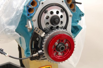

The car is being setup with a Big Block Ford. The best option available is the MSD 8644 flying magnet crank trigger setup for the primary trigger.
This pickup has 4 trigger magnets each 90 degrees apart from each other.

The most important thing is that the possition of tooth on crank wheel will be 40-60 before TDC.
The location of CAM tooth is not important (should only not overlap with the ckp tooth),you can configure it in software.
However if it is possible 36-1 or 60-2 trigger wheel would be better solution (due to higher signal resolution)

I would not use the MSD flying magnet crank trigger. I have seen many cases where they do not work with engine management systems. You need at least 24 teeth to get good resolution for ignition. That website shows many trigger wheels with multi teeth. You need to use one of them. The MSD thing that is only suitable for MSD ignitions.

going to a 36-1 wheel isnt to hard
