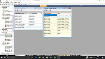

Has anyone ever run an EMU Black on an M62B44 BMW V8?
I have seen a thread where someone has run one on the older EMU.
I would like to use the standard 3 wire BMW COP's if possible?
The coils would be fired in wasted spark
Firing order 1-5-4-8-6-3-7-2
Just having a play in the software and I set the ignition/injectors as per attachment does that look correct?

injection looks correct and ignition should be fine running 2 standard coils at a time
wiring for ignition sequence 1234:
IG -- cyl
1 -- 1,6
2 -- 5,3
3 -- 4,7
4 -- 8,2

Do I need to have the 8 ignition events to link the injectors too?
Also I plan to run DBW my throttle body isn't listed in the wizard can it still be used by just setting min and Max's and using the other tables from a Bosch throttle body?
yes you will always need to assign ignition to all 8 events just repeat the sequence, but for the injectors you could wire them in pairs if you wanted to use only 4 outputs then you would only need to assign the first 4 events to the injectors and select squirt twice per cycle.

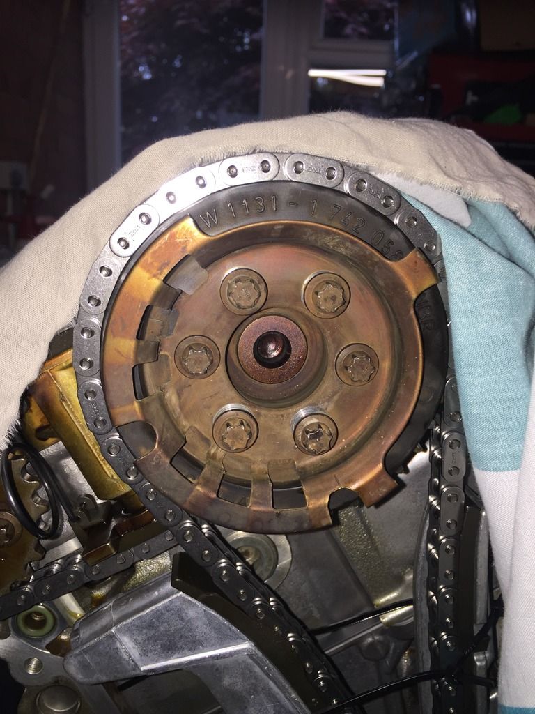

I've got my ecu on order now so I have started making a startup map.
I have found a map for an older emu which gave me some crank trigger pattern info to try but they didn't run the cam sensor.
This is the trigger wheel on the cam which mode would should I be looking to use
