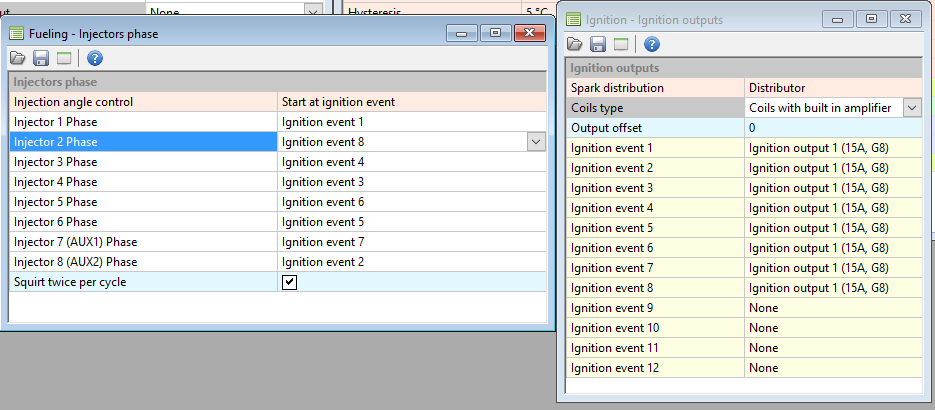

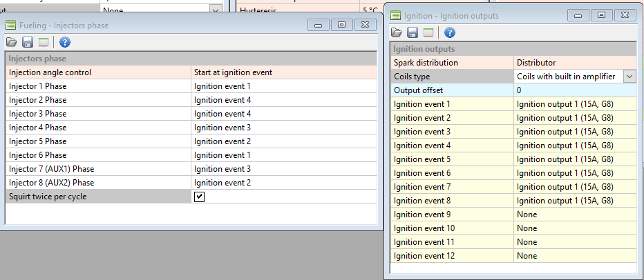

Just to make sure I got it right: So like in the picture it would be OK? I have selected to "pair" injectors(/cylinders) with same TDC (firing order is 1,8,4,3,6,5,7,2) I don't know does this make any sense or not or does it even matter which injectors you pair as with distributor you don't know which cylinder fires anyway... BTW..
With "squirt twice per cycle" Wouldn't this be physically exactly the same : Thanks
I have selected to wire individually to each injector to allow fully sequential maybe later on.

The injectors opens in 720 deg cycle (once per 720 degree).
When you select squirt twice, each injector will be fired twice during 720 degree cycle (eg. at ign event 1 and second time at ignition event 5)
