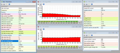

I set the frequency at 500Hz and dialed the duty cycle back to around 40% base dc. I'm using the PID controller with the stock setting as well as some ignition advance with the PID for small changes. The car idles better than stock. Here is an image of my settings.

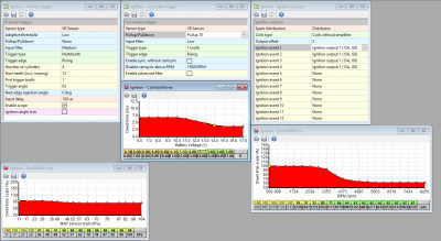

I was having repeated issues with a misfire at about 6000 rpm when hot and 4000 when cold. I think I narrowed that down to coil dwell settings. The motor has fresh plugs gapped at .030 (oem recommends 1.1mm or .043). I set the base dwell to about 3.9ms at 14v which is a little higher than most standalone ECU's put this for the OBD1 ICM. I then have the Dwell RPM correction pull dwell down to around 60% by 5000RPM. This seemed to have cleared up it most of the misfire problems but it was still thre everyone once in a while under hevy throttle. I also added map correction that would pull it back even furth to about 88%. This seemed to clear up all misfire issues. This runs the dwell down around 2ms at the low point. It seems like that is right on track for this load/RPM area when comparing to other setups. I don't really like the way the EMU does the coil dwell calculations. I'd rather have an XY graph with voltage and rpm. There is no real circumstance where high RPM and low voltage should try to run dwell higher but there are times when low rpm and low voltage would. The dwell time at high rpm is really being limited by the time it takes distributor to reach the next cylinder.
