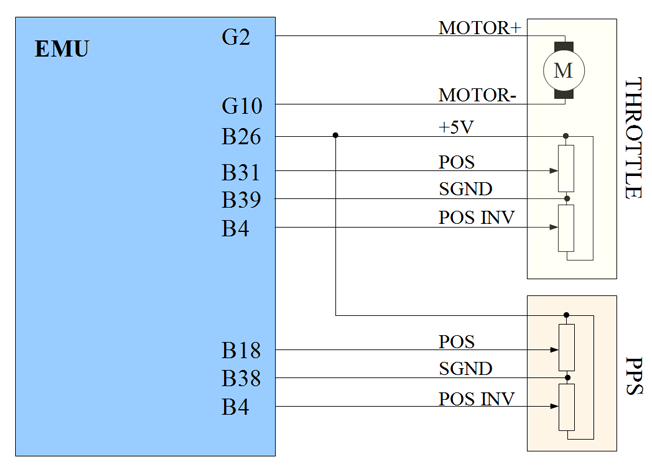

I'll going to install my Black EMU system to my BMW e46 330 turbo.
I was thinking of using DBW system, but do not really know how to go into the box with the cables from the pedal, etc.
There are 6 cables from the pedal, but I have no idea which is which.
As I understand, then these four go to the box from the pedal?
POS
SGND
POSinv
And last one +5v
POS
SGND
POSinv
And last one +5v
Re: BMW 330 turbo EMU black
I'm working on one in Canada.
DBW works. but you must use G2 and G10 as the throttle motor drivers.
TPS is also wired as the pedal + position sensor. this is also necessary.
select your other three inputs and you should have a working DBW.
the throttle response will be strange so you will have to play with the maps.
use two aux drivers for the idle control motor.

one more little tip dont use AUX 1or 2 for the idle motor since thay dont have the flyback protection (no flyback enables 1&2 to be used for injector drivers during an 8cyl sequential install)
Can`t use anything except Hbridge 1a and 1b.RHD wrote:one more little tip dont use AUX 1or 2 for the idle motor since thay dont have the flyback protection (no flyback enables 1&2 to be used for injector drivers during an 8cyl sequential install)
DBW Throttle body must use H-bridge 1A and 1BRHD wrote:one more little tip dont use AUX 1or 2 for the idle motor since thay dont have the flyback protection (no flyback enables 1&2 to be used for injector drivers during an 8cyl sequential install)
Idle motor can use any aux driver.
best to use flyback protected aux driver.
mine are on Aux 5 and Aux 2 - I added the diode.
