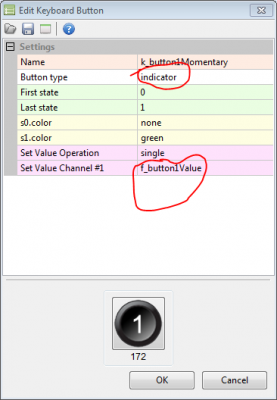

But you can do it by using "Indicator" type of keypad button.
The "Indicator" type is similar to "Non-latching", but shows colour based on specified channel.
Attached sample project.
You can change default active radiobutton by changing default state of Set-Reset Latch.
Please use f_button1Value and f_button2Value in your project.

Just tried...
