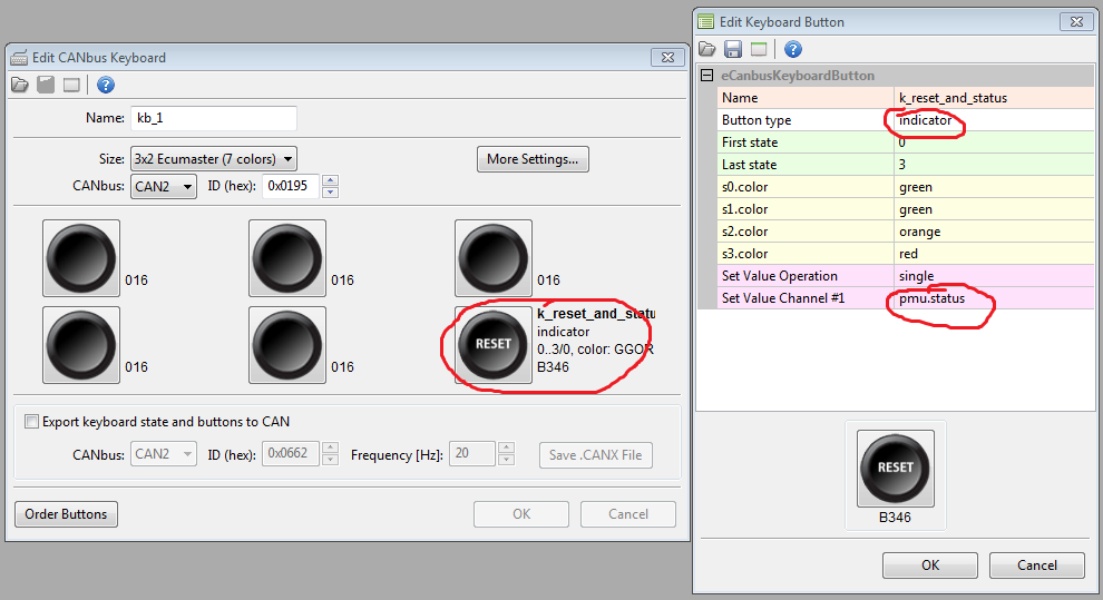

About the Master Retry. Please find below how to set it up:
1. You need to define the keyboard button of type Indicator and connect pmu.status as the input channel.
2. You need to set the Master Retry Channel in Global Outputs Settings
kb_reset_and_status.pmu
