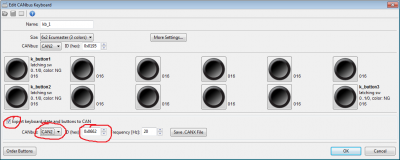

There are two steps to connect PMU keypad to Link ECU.
In PMU:
1. You need to export keyboard state to CANbus. It can be done by using PMU built-in keypad export.
Make sure to select proper CAN, the same CAN where Link ECU is connected.
Use ID default 0x662 hexadecimal (=1634 decimal)

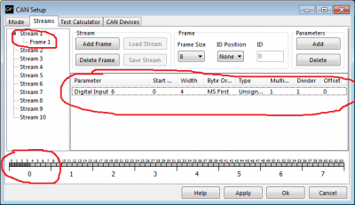

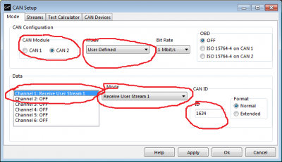

Link ECU:
2a. You need to configure Channel to receive data. You need to select proper CAN, the same CAN where PMU is connected. Use ID 1634 decimal (0x662 hexadecimal). Don't be confused: Link ECU uses the decimal format, while PMU is using the hexadecimal format of ID.
2b. Setup the parameter receive.
The format of keypad frame is as follows (Link ECU notation):
Bits 0..3 - Button 1 in the upper row
Bits 4..7 - Button 2 in the upper row.
Bits 8..11 - Button 3 in the upper row.
Bits 12..15 - Button 4 in the upper row.
Bits 16..19 - Button 5 in the upper row.
Bits 20..23 - Button 6 in the upper row.
Bits 24..27 - Button 1 in the bottom row.
Bits 28..31 - Button 2 in the bottom row.
Bits 32..35 - Button 3 in the bottom row.
Bits 36..39 - Button 4 in the bottom row.
Bits 40..43 - Button 5 in the bottom row.
Bits 44..47 - Button 6 in the bottom row.
Attached three images how to set up each step.
First I need to say that I'm not the Link ECU expert.
In PMU:
Link ECU:

Order of images in my previous is reversed. There are some issues with PhpBB and I can't edit it.
