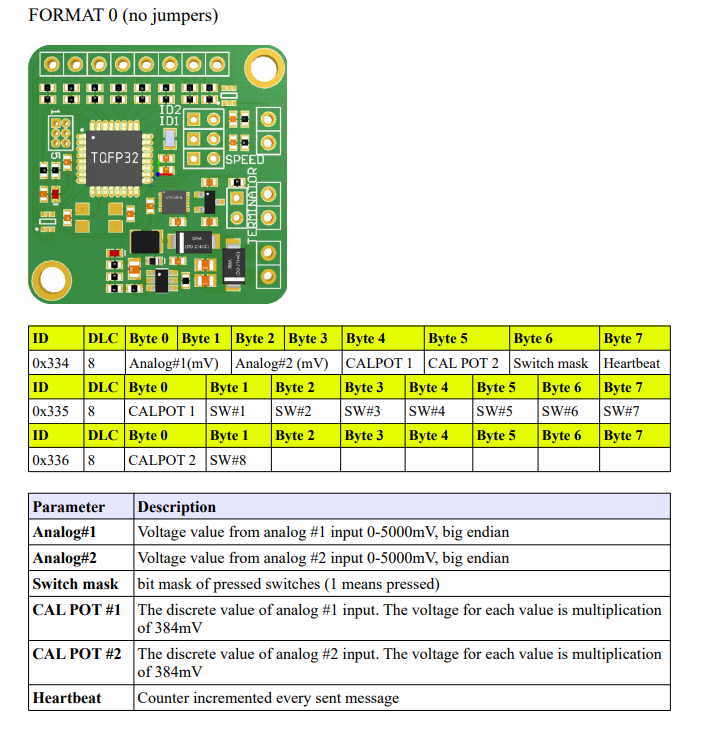

I use CAN switch board for my steer switches using simple switch mask. I wonder what is SW parameter and how it works. I couldn't find in manual.

There is .CANX file for the Switchboard included in the PMU Client (attached a copy).
Please configure the Switchboard using jumpers on the pcbboard for ID2 (the ID will be 0x666).
All 8 switches are switches to ground (Active Low in PMU terminology).

What is the meaning of parameter SW#1-SW#7 on ID 0X335?

It's the copy of the information from the Switchmask. Some ECU does not handle bit extraction.
It's 0 (zero) or 1 (one) passed as the whole bytes in the CAN stream.
Consider using ID2 at 0x666. The support is integrated into EMU BLACK, maybe you can use it in the future.
