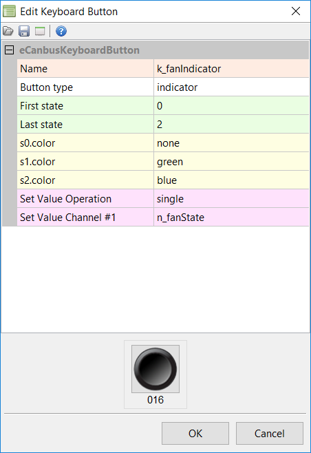

Below is a solution to your problem.
The keyboard button will have 3 states - OFF, GREEN, BLUE (OFF, ON from CAN and ON by user).
When you turn on the ignition it will be controlled by CAN. When you press the button it will turn BLUE and the output will be ON. It will stay until you press the button again.
The following elements are used:
- k_fanIndicator - keyboard button of type "Indicator" and colors: NONE, GREEN, BLUE
- c_ecu_fanStatus - CANbusInput from the ECU with values zero or one.
- f_fanOverride - is the logical Function that holds the override status
- n_fanState - is the Number that holds the state (or color) of the button 0(OFF), 1(ON from CAN), 2(ON by user)
- o_fan - the PowerOutput
Formulas:
c_ecu_fanState configured
f_fanOverride = toggle(k_fanIndicator, rising, default:0)
n_fanState = 2*f_fanOveride + c_ecu_fanState
k_fanIndicator.setValueChannel = n_fanState
o_fan.active = n_fanState
Attached is PMU project and configuration of the k_fanIndicator button.

- fanOverride.pmu
- (24.88KiB)Downloaded 118 times
Re: Change button status
(The project was not tested on the real PMU device, so please let me know if you have any problem with it.)
