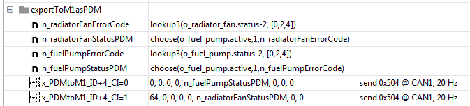

I've added export of these fuelPump and radiatorFan outputs status to M1.
The meaning of the status in Ecumaster PMU is as follows:
0 - off
1 - on
2 - undercurrent
3 - overcurrent
7 - thermalShutdown
In the Motec PDM the meaning of the status is as follows:
0 - off
1 - on
2 - overcurrent
4 - fault (similar to PMU's thermalShutdown)
I'm using for each output the following formula:
errorCode=lookup3(pmu_o_status-2, [0,2,4])
pdm_status = choose(pmu_o_active, 1, errorCode)
Exporting is done to BaseID+4 (0x504)

Two frames need to be sent with different CompoundIndex (bit shift is 6)
- CompoundIndex=0: value 0 at byte0 (it's 0<<6 in C notation)
- CompoundIndex=1: value 64 (0x40) at byte0 (it's 1<<6 in C notation)

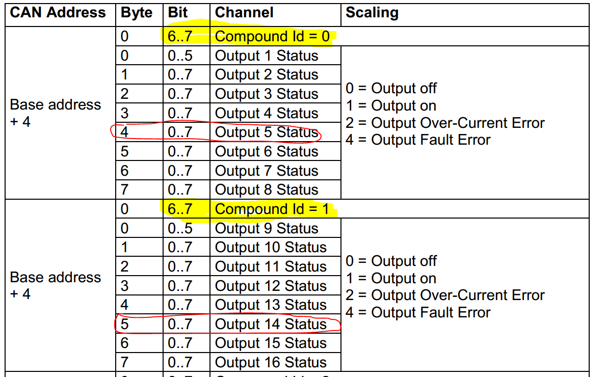

1. in CANBus export "x_PDMtoM1_ID+4_CI=1", can you explain meaning of value 64 in channel 0

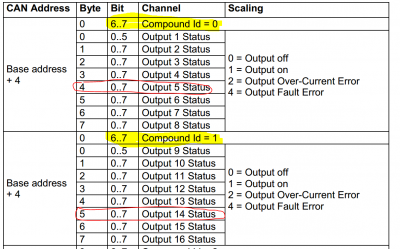

Re: PMU to Motec M1 CAN stream
