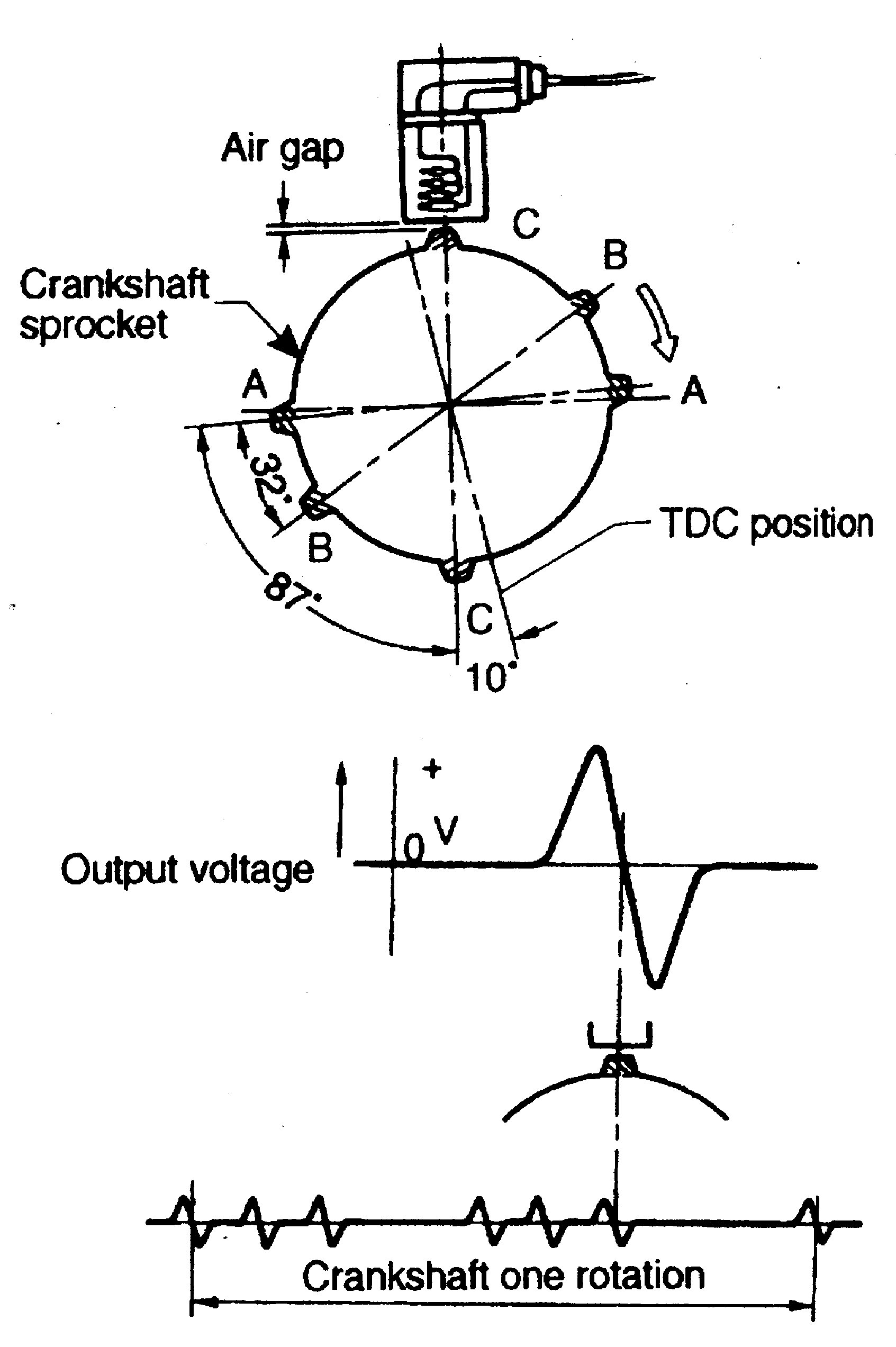

HI I have a Subaru EJ20 with the Ecumaster unit the Subaru 6 teeth on the crank, what should I enter in the First trigger tooth box and what should I have in the Trigger angle box ??
