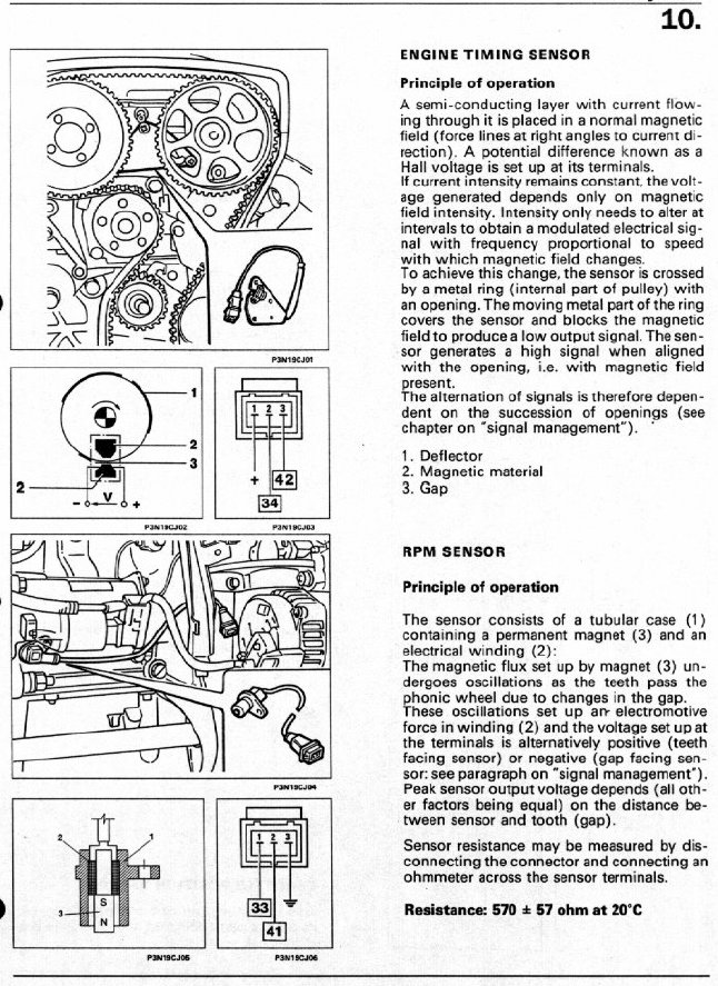

Im new in the EMU world.
tryring to get a fiat 1.8 16v to run..
just wire it in.
setting up the ecu now.
can some one please look at the trigger settings i shoul use?
cheers
the rotation is the wrong way on in the pic!...
just wire it in.
cheers

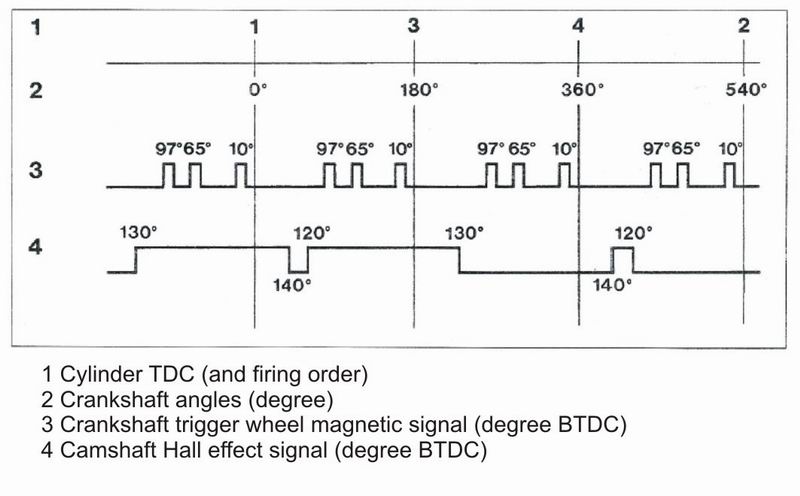

I was thinking...
2e tooth..
65 degrees.
I was thinking...
2e tooth..
65 degrees.
Re: trigger request fiat 1.8..
that is a weird pattern, maybe the gurus from ecumaster will have another idea, but i would use a simple 36-1 or 60-2 trigger wheel.
cant you fit like a pulley from fiat punto 1.1? it already have a 60-2 trigger wheel on it
It's the same as a Subaru 6 tooth.
And that one is supported by the emu
Just need to know what to put in as the trigger
Is it Fiat Stilo ?
It looks the same as subaru.
So I would give a try the following settings:
car is a Barchetta
this is the scope i got now.
and the settings
and the settings
- scope_201635_1129.emuscp
- (93Bytes)Downloaded 65 times
Please try my settings. Should work. Of course check the spark with the timing lamp.
I can not get her to fire up..
Timing is not in the same place every time.
Seems like its using a different start position?
this is the scope.
with the subaru 6 tooth settings i get a lot less triggers.
plus in the manual it say that it does not work with cam sinc..
so should i go group injection and wasted spark?
- 6tooth.emuscp
- (111Bytes)Downloaded 61 times
- fiat scope.emuscp
- (261Bytes)Downloaded 79 times
The scope looks ok. This signal is converted to 2 tooth per revolution.
It works with cam sync. I sent you configuration.
You have to use cam sync otherwise it will not work.
