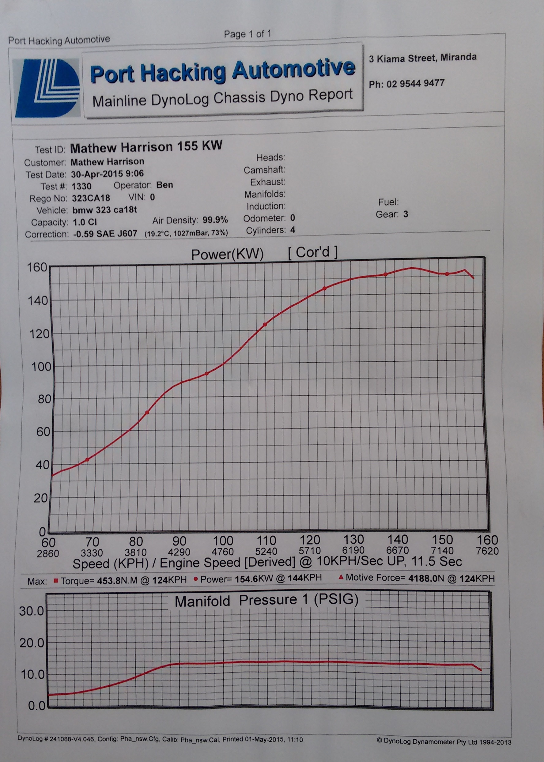

you dont need closed loop if you set up the ref and target tables well you can use some quite aggressive DC error correction slopes (assuming the valve is working corectly!)
this is a little ca18 we did last year running a 3 port MAC valve and a very low pressure spring in the wastegate, look at the manifold pressure!
Re: Issues with boost control - very unstable
This looks rock stable. I think i understand waht you mean. I will try it as soon as i get rid of the slipping clutch
