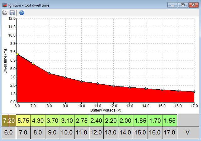

Maybe lower the dwell time.

"Maybe lower the dwell time"
How many point lower? 0.2, 0.4, 1.0?
Currently using 2JZGTE VVTI stock coils.
Should "Predefined coils" be change? Which one?
Now first option selected.
