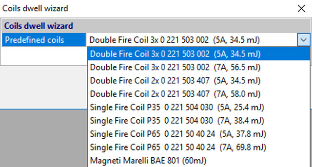

Post by paryoto.semesta » Mon Nov 07, 2016 6:39 am
"Maybe lower the dwell time"
How many point lower? 0.2, 0.4, 1.0?
Currently using 2JZGTE VVTI stock coils.
Should "Predefined coils" be change? Which one?
Now first option selected.

"Go to: Ignition->secondary trigger->sencitivity switch rpm -> 2000"
Try to lower to 2000.
Engine struggles to rev above 4K RPM (car not moving).
Change "Predefined coils" to second option.
Same result.
