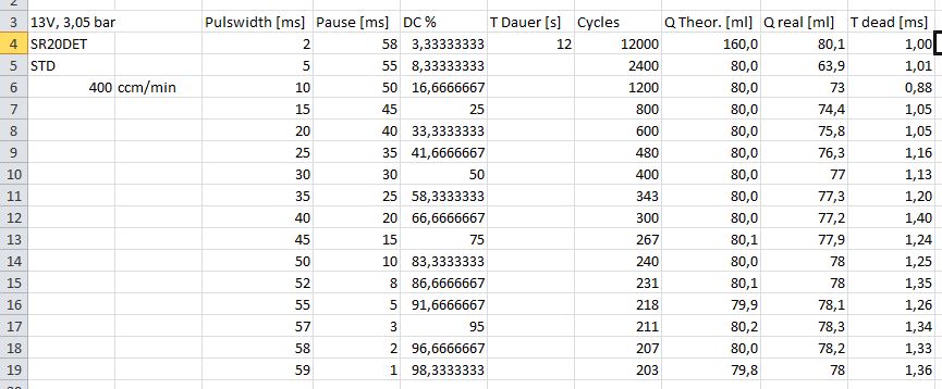

I tried to do measurings, to determinate the deadtime of my original SR20DET Sidefeed Injectors but discovered problems.
The deadtime of the seems to be influenced by the pulsewidth itself, which theoretically should not be possible (in certain Duty Cycle regions).
Did your measurements put out similar dependencies? Please see my attached picture.
The only explaination I have for this sympthom is, that the fuel Pressure is too much inconsistent over the whole range. I use a normal RB25DET Fuelrail with OEM Fuel pressure Regulator and approx. 0,5m Fuel line with a Fuel Filter inline. Did you use some certain Fuel pressure Dampeners or similar to achieve a real CONSTANT Fuel Pressure?

Clem i am not Patric, but i think that everything over 20ms is little too long
what we have:
6000RPM and 1injection per 2 revs
so 3000/60 = 50injections per second => 20ms per each injection at 100% DUTY (your 60ms means, that you want 100% DUTY at 1500RPM, and i think this will never happen)
Now what i think is, that if your pulse width starts to be too long, the coil in injector start to warm up, and the resistence of the coil start to climp up also..... result, less current and less magnetic field to move needle inside the injector and larger dead time.
Also diference 0,3ms of death time at 60ms pulse is very low, and will not make huge AFR change.

I can't see the picture from here but Karel has right.
A realistic max PW is 20-24 msec.
I tested 2-4-6-8-10 msec.
I made a fuel supply by putting 3 bar air pressure on a little container with 1L petrol.
This way i could control the pressure very good and i didn't need a fuel pump.
You can just see the system on my youtube movie.
What is your max and hold injector current ?

AAAh Ok I did not think very much about the cycle time as it should be not significant to the results. But it makes sence as you explain it!
Ok thanks for the Explaination.
I used High-Z Injectors with no current measuring... But as they have approx. 11Ohm Resistance, there should be about 1 A current, the whole cycle long.
I will test soon with your given pulse and pause times and report :)

I still am confused about the correctness of this measuring method. PBU your estimated deadtimes (of the two injector types you sent me) are also depending on the pulsewidth :?
You let excel calculate the deadtime via a statistic model, I am not sure if this really IS correct :?: Statistics is not my favourite friend...
Could it be, that the closer the pulsewidth to the deadtime, the more exact is the deadtime calculation?

I send you 2 examples of the calculation.
One gives a graph at a specific battery voltage with dead calculation.
The other one is the same calculation!! over a given battery voltage spread.
I can assure you this method is widley used and correct.
It has nothing to do with statistics . It's only the mathematical calculation where the graph line would toutch the horizontal axis if it would run further.
This value is the dead time value.
Meaning , during this puls time the injector gives no fuel output.(lost time )
Only issue is that the injectors in the very low PW are not linear and so with the excell calculation here whe have a little error.
Hope it makes sense. :P

Thanks for the explaination! I always thought you would like to calculate other times within to the deadtime (like explained in the graph on the first page...)
Now I understand :) Thanks again!
