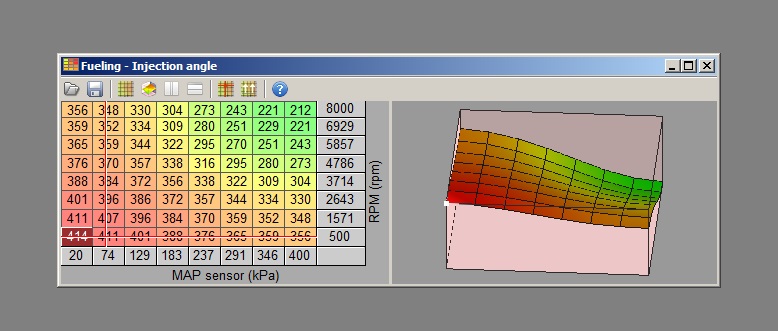

how do I configure the injection angle?that's right, I built the table?

In my experience not very important in most cases with port injection.
Just set it flat 360deg for begin. If want, fine tune low load/low rpm range when most of the tuning sorted.

it turns out?

Correct.

characteristics of the camshaft
The strategy of injection timing:
End of injection ???
Start of injection ???
at the beginning or the end??

It does not matter if you set start or end of injection.
Cam profile is not going to help, you have to tune it for best efficiency.
But as i said before, in my opinion and experience, it is not very important with port injection in most cases.

samvel wrote:It does not matter if you set start or end of injection.
