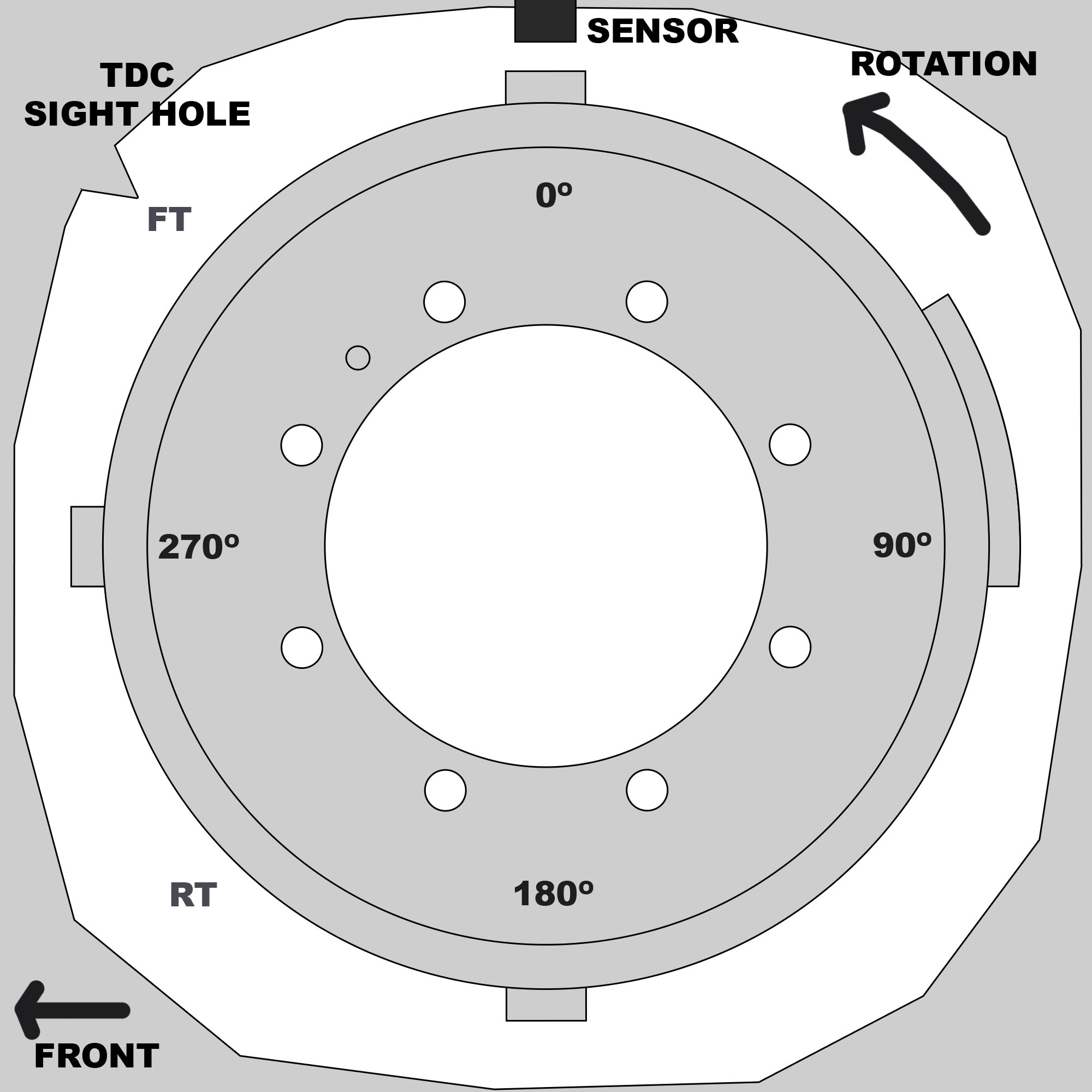

i will make the changes you suggest later today, do i need to change the polarity or the crank sensor for falling edge detection or jut in EMU. At the momentcrank sensor goes positive first then negative as it rotates.
I have also attached a drawing of the trigger tooth pattern as this has an unequal pattern and may complicate matters.
I have the injectors turned off at the moment while i am just cranking and trying to set timing as my face is right next to the turbo dump pipe :D
thanks for your help
Re: sync but no spark
Post by RHD » Fri Jan 27, 2017 10:23 am
ok the trigger will cause big problem if the edge is wrong, it doesnt matter which way the sensor is connected just take a long scope setting it to falling and a long scope of it set to rising and pick the one that has the bars evenly spaced.
you may actually run into problems with this trigger, since it may centralize the signal over the tooth at speed so you may need to change to a hall type sensor and use the rising edge or modify the teeth so they are all the same size

0k looks like in both cases the crank signal is very uneven, this will cause some problems, but in rising case you are now getting a spark count! ... in particular the last crank you did, so it might fire?
Unfortunately the only option might be to modify the trigger wheel. You might be able manipulate the signal somehow but thats way beyond my technical knowledge.

i Have obtained a spare flywheel so we are going to modify the trigger pattern to give 4 even teeth
