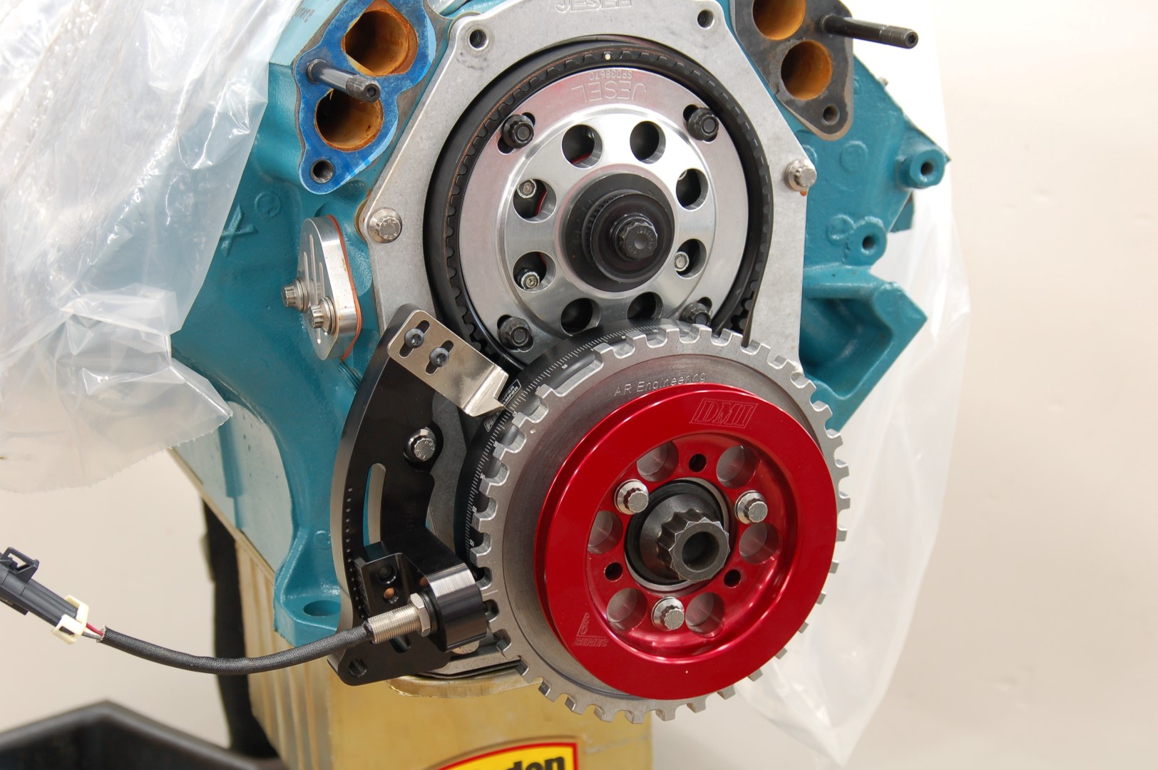

I would not use the MSD flying magnet crank trigger. I have seen many cases where they do not work with engine management systems. You need at least 24 teeth to get good resolution for ignition. That website shows many trigger wheels with multi teeth. You need to use one of them. The MSD thing that is only suitable for MSD ignitions.

going to a 36-1 wheel isnt to hard
