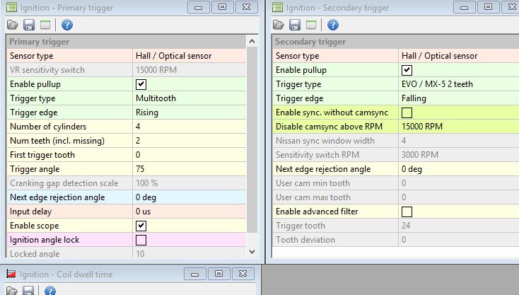

you have the same settings i have for a evo3 with cas on camshaft like this:
these are my settings:
if your trigger on crankshaft is only 2 teeth like this settings are ok maybie you need to enable pullup
