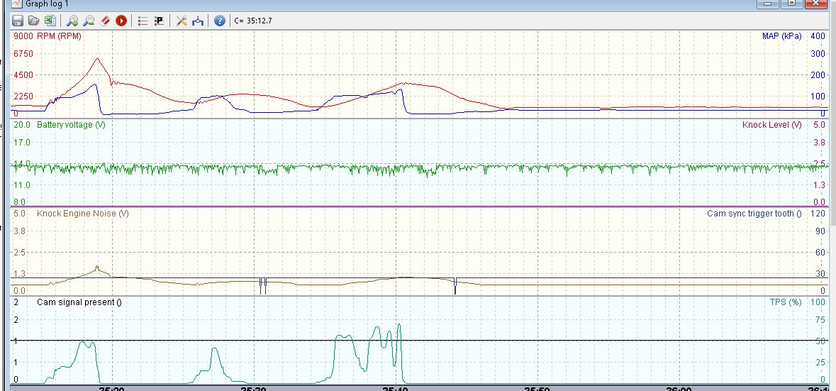

I'm encountering an issue with cam signal dropping out. It should be a constant 24 tooth, but occasionally it will drop to 1. This is odd, cause the sync is still present. This issue started, after I swapped transmissions and clutch setup. (2jzge with 7m cps...was on W58 5 spd, but swapped to pontiac ar5 trans.)....Through tech support, we have adjusted the edge rejection angle, under secondary triggers. this does make a slight difference, but its still present.

Lots of things have changes the past few weeks. I replaced the Timing Belt (theory was that the belt might be stretched causing fluctuations on the 7mgte CPS)....replaced all wiring and re-did entire harness. This was done for many reasons. I was changing injectors, adding flex, adding egt, adding A/C wiring back in, and also added a 36-2 crank trigger wheel..and lastly changed to emublack, so I would have to repin it anyways.
7MGTE CPS is still used for the 1tooth cam sensor, the 36-2 crank wheel is used for the crank trigger. These are prowire tefzel shielded wire. Using the solder-heat-shrink termination for shielded wire.
Oscilloscope shows perfectly clean signal at both 7MGTE and also CRANK. No noise directly from the sensor.
The only way the motor will run is if I set DISABLE CAMSYNC ABOVE 600rpm....any higher the tooth count goes erratic, like my first post picture.
I have tried 10K resistor inline on secondary cam, also 20K resistor inline with cam and made zero improvement. EMUBLACK has builtin 4k7 resistor, and that made no difference.
So, in conclusion. This issue existed on old EMU, old wiring with 2jzGE dizzy. Existed on old EMU, old wiring, 7MGTE CPS. Existed on EMUBLACK, new wiring, 2jzGE dizzy. Existed on EMULACK new wiring 7MGTE. and Existed with multiple resistors.
