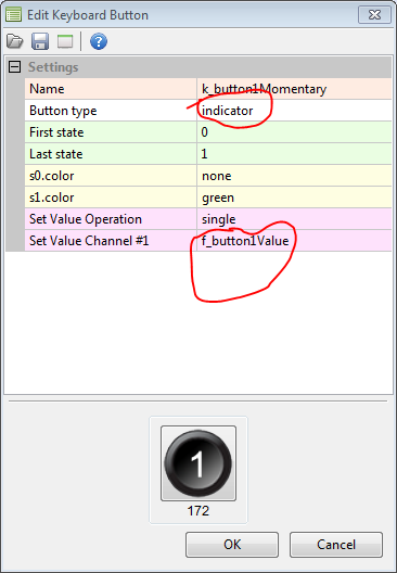

But you can do it by using "Indicator" type of keypad button.
The "Indicator" type is similar to "Non-latching", but shows colour based on specified channel.
Attached sample project.
You can change default active radiobutton by changing default state of Set-Reset Latch.
Please use f_button1Value and f_button2Value in your project.

Just tried...
Works after some playing. Big thank you. Didn't think this way... Really have to get more practice. Would be great if we could somewhere have a collection of examples for doing such things. We can really do a lot with your system and I appreciate the degree of freedom but because of the complexity of some functions it would be great to have something like a wiki where everybody can propose his own cool functions. Or at least some catalog of example functions. You have so much racing experience and know how to do cool stuff...
