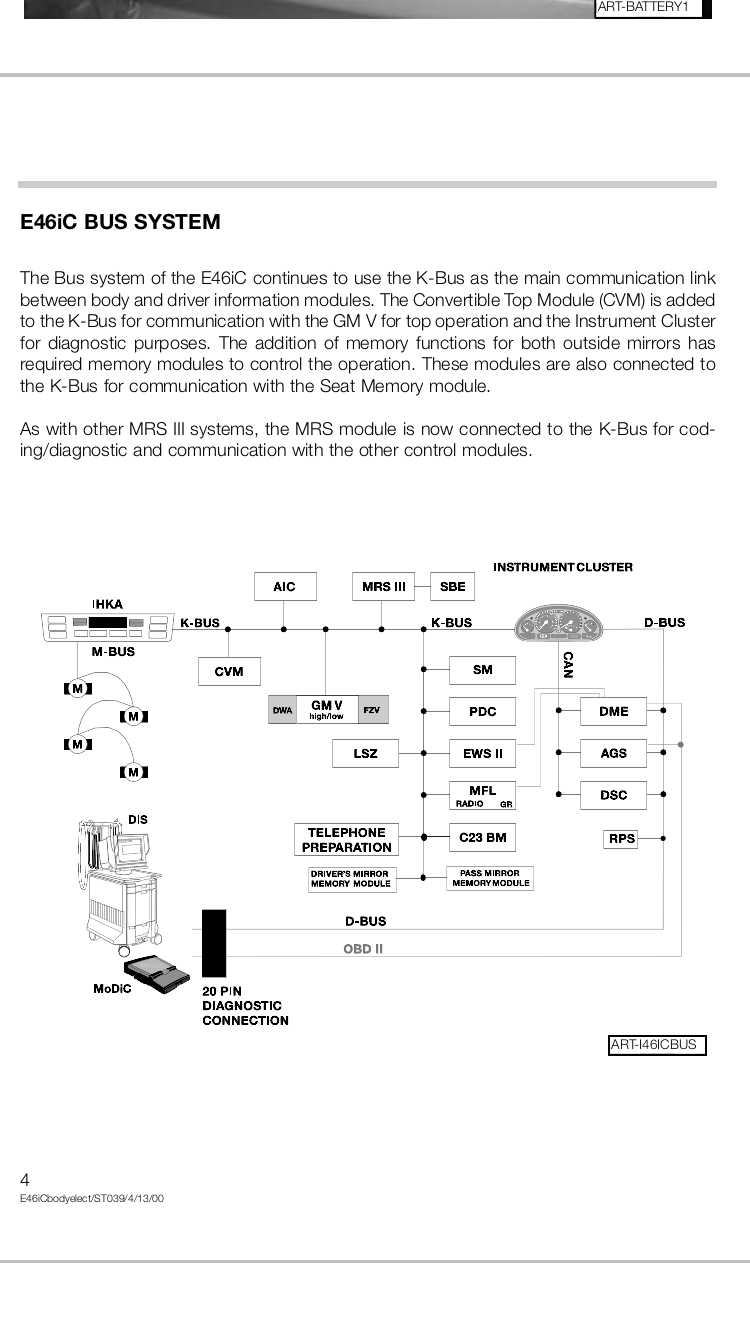

What do you mean by "other CAN-bus"? There is only one actual CAN-bus and the other ones are BMW specific. According to BMW WDS, the wheel speeds are exchanged via CAN-bus. Two pictures attached.Jadzwin wrote:Hi!
The problem is that the ABS is on another CAN bus. To make it work you need to connect CANs toogether and use user defined CAN to check if it work.
Then we can add this into the software

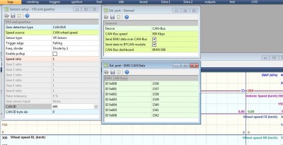

could anyone help me out ? Updated ECU firmware, downloaded latest version of software where it says that e46 CAN VSS is supported now. But my ECU still doesnt see vehicle speed. dashboard works fine by CAN... but no VSS. What is wrong with settings ? What CAN ID to use ?
