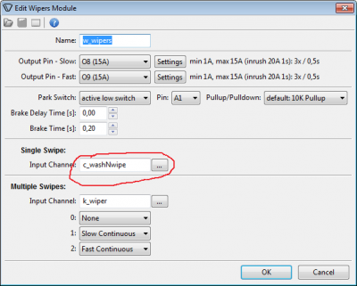

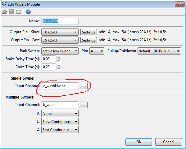

1. Setting keypad button k_wiper by setChannel is not required. I've removed these setting from your project.
2. The easiest way to activate the slow mode of the wiper is to use "Single swipe" option. There is Input channel for the Single swipe. I've used it with your washer button.
Please find attached a modified project that uses Single swipe.
(more in the next post)
- wipers1_singleSwipeByWasher.pmu

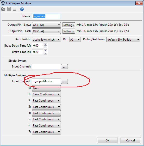

3. Changing the formula of the slow/fast output is not recommended, as it will be changed every time you use Wipers Module.
It's better to modify input signal.
Please find an attached example that activates the slow mode for 3 seconds when the washer is clicked.
Instead of using k_wiper directly I route it by math channel. And then use this math channel as the input for Wipers Module.
a. First we need to generate 3s second pulse: f_washerPulse = pulse c_washNwipe.rising 3s
b. Then we need to mix the k_wipers and the pulse: n_wiperMaster = max(f_washerPulse, k_wiper)
c. Finally use the n_wiperMaster in Wiper Module
(Also, the f_washerPulse can be used for washer output. (Or not, as you prefer.)

You need to "mix" two channels.
One (k_wiper) has values 0, 1 or 2.
The second (f_washerPulse) has values 0 or 1.
You want to select the greater of these two channels.
Max (the maximum value of two values) gives you what you need.
max(0, 0) = 0
max(0, 1) = 1
max(1, 0) = 1
max(1, 1) = 1
max(2, 0) = 2
max(2, 1) = 2
This only one solution to your problem. There are other solutions that solve your problem in the same or similar way.
