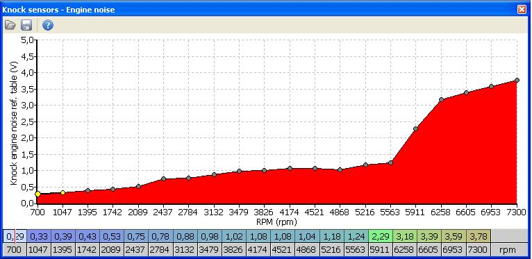

Setting up the knock control at a 1,8T AGU
Hello guy´s,
please can you check my knock kontrol settings, i'am not 100% sure if the assignment of ignition events is right.
At the pictures you can see my settings, if i understood the funktion right i think it is correct. But only to be 100% sure port your opinions.
Thanks a lot
Thanks a lot
Re: Setting up the knock control at a 1,8T AGU
First I would change gain (increase at least to 1) and adjust integrator value.
Your ignition order is 1-3-4-2 with the offset 2 so it is like
4-2-1-3
For event 1 you need to sample ks #2
For event 2 you need to sample ks #1
For event 3 you need to sample ks #1
For event 4 you need to sample ks #2
Knock actions looks ok.
4-2-1-3
