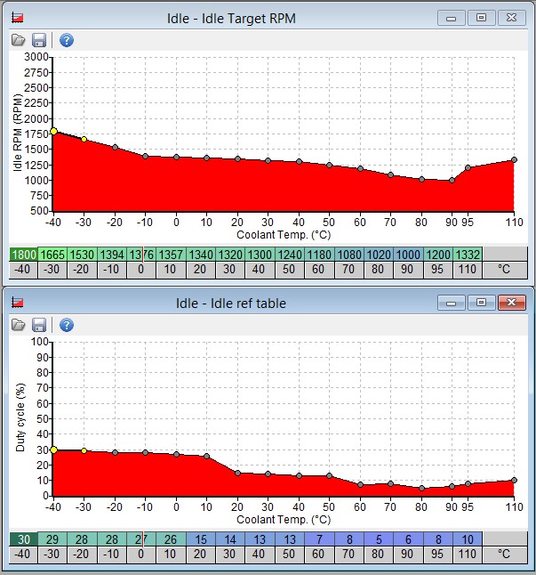

Re: Fuel Pressure Goes To Zero When Car Starts
Luckly the usb cable they supplied works !! I was able to get the car running. But can't get it to idle on its own.
It needs my foot on the gas in order to maintain a 1000 rpm idle.
If it does idle, it idles extremely rich ( in the 9's ) and barely is capable.
So i figured id try to lower the injector trim down. Starting from a 100% and the lowest i could get it was about 80%. Any lower than that it just wont idle at all.
Any tips on how to make the car idle ?
2JZNA-T wrote: Any tips on how to make the car idle ?
you can try correct it by idle ref table and correct frequency of stepper motor ( assuming you already know correct step number )
Please contact us on monday at tech(@)ecumaster.com. One of our engineer will connect to your computer and check your settings.
got the car to idle now, the idle rpm ref was at a 100% i've been slowly stepping it down. And got it to go from barley idling at 9.40 to now about 10.30 afr.it idles alittle more reliably and much more smooth. But i can tell i need to mess with more.
Modify your VE table in the idle area
