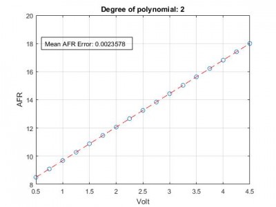

For X-series 30-0300, try this one instead.
Definitions spec:
volt = [0.50 0.75 1.00 1.25 1.50 1.75 2.00 2.25 2.50 2.75 3.00 3.25 3.50 3.75 4.00 4.25 4.50];
afr = [8.50 9.09 9.69 10.28 10.88 11.47 12.06 12.66 13.25 13.84 14.44 15.03 15.63 16.22 16.81 17.41 18.00];
coef0: 7.3116
coef1: 2.3761
coef2: -0.00016512
coef3: 0
coef4: 0
coef5: 0
Interval: [8.4996 18.0008]
Mean AFR Error: 0.0023578
wideBandO2SensorAEMUego_X-series_30-0300.txt
Change ext to .def
(412Bytes)Downloaded 63 times
