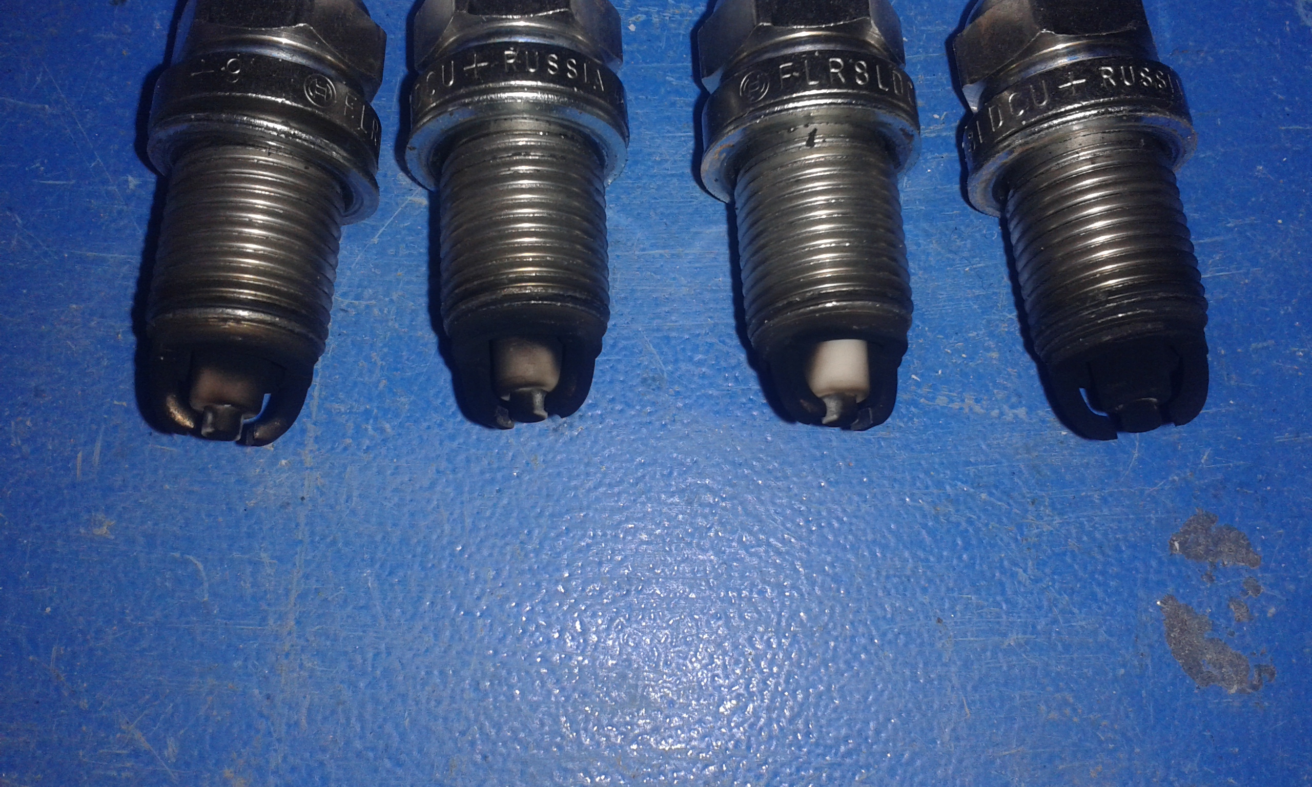

peter1002
Posts:22
Joined:Tue Sep 02, 2014 7:59 pm
Re: ignition problem Opel Z20LET
Post by peter1002 » Tue May 12, 2015 8:18 pm
have it all changed still the 4 cylinder
Today I drove 20 min normal then it started again
astra vxr
Posts:148
Location:peterborough uk
Post by astra vxr » Tue May 12, 2015 9:58 pm
how old are the plugs ?
its pig rich what ever the problem is
have you a differnt coil pack to try even though yours is new i would change it for another one and try it
i still think it might be a problem with coil pack getting hot and breaking down or dwell is wrong and its over heating
on a side note : best coil pack if you are running wasted spark is the ecotec one one we used them for years with 3 bar of boost and never had a problem with one

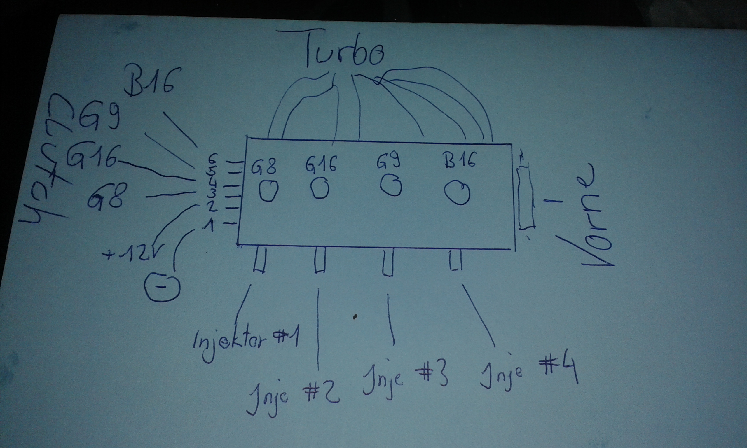

peter1002
Posts:22
Post by peter1002 » Thu May 14, 2015 4:22 pm
here I still have the connection diagram
and scope
scope_2015514_1447 15.05.2015.emuscp
(280Bytes)Downloaded 123 times
20150514_1523 15.05.2015 log.emulog
(714.23KiB)Downloaded 115 times
15.05.2015 emu.emu
(86.54KiB)Downloaded 120 times
peter1002
Posts:22
Post by peter1002 » Thu May 14, 2015 4:24 pm
fotos
