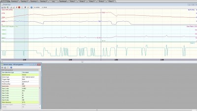

I was looking in my logs from today and see that there is problem with gear detection , as you see in screenchot gear ratio is 52 ( 60 +/- 10% ) for fort gear ) but it shows 1st gear
Wuniek
- Posts:115
- Joined:Fri Aug 15, 2014 6:38 pm
- Location:Warsaw
Post
by Wuniek » Wed Jun 17, 2015 7:26 pm
your speed ratio and freq divider are quite big numbers, in my setup and other that i saw values of speed ratio was 0.1-0.3 and divider 1
killerbee - Posts:67
- Joined:Mon Aug 18, 2014 3:12 pm
Post
by killerbee » Wed Jun 17, 2015 8:15 pm
I can lower the values but it is calculation I do not think that there is problem of that , problem is why at gear ratio 52 it shows 1st gear which is not nearest one
- Site Admin
- Posts:1445
- Joined:Tue Aug 12, 2014 11:27 pm
Post
by Jadzwin » Wed Jun 17, 2015 8:21 pm
If there is no gear ration in the defined tolerance the gear is automaticaly set to 1
