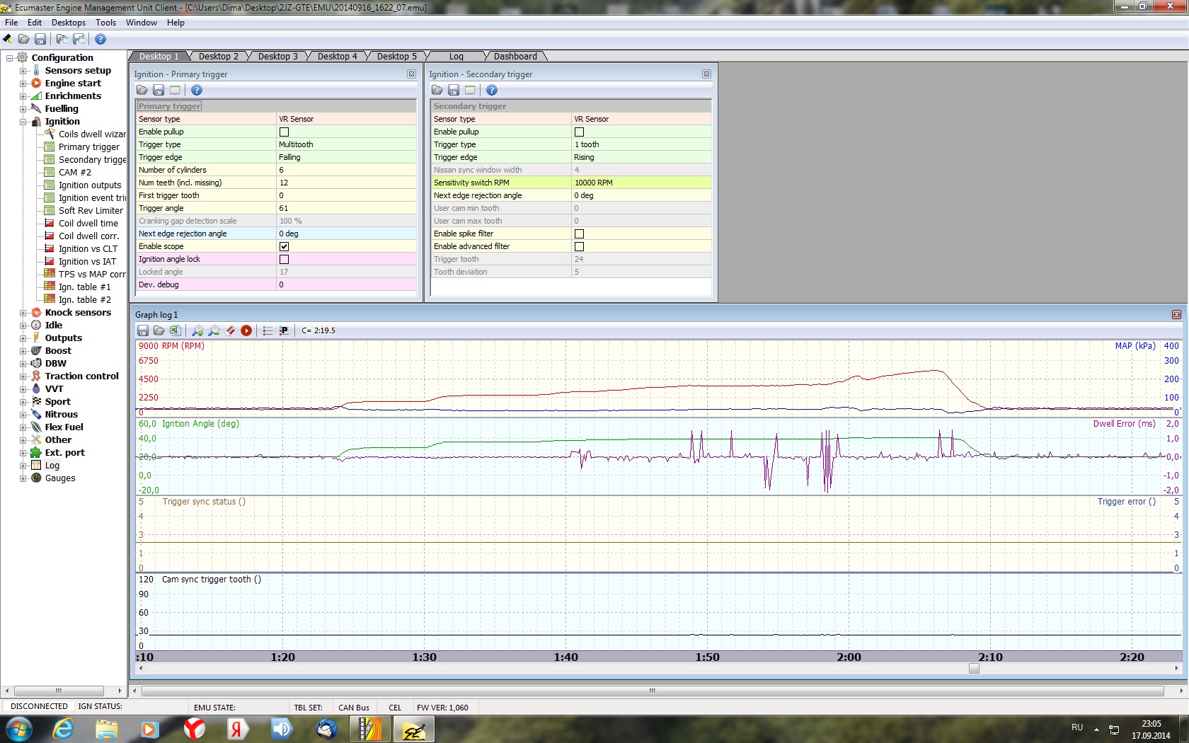

Hello!
My problem - if rpm above 2000 - begin cam sync trigger tooth error and dwell error...

check on emu scope how near is the edge of cam signal to edge of crank signa.
lom51
Posts:14
Joined:Tue Aug 19, 2014 11:41 pm
Re: Cam sync trigger tooth error 2jzgte
Post by lom51 » Wed Sep 17, 2014 9:11 pm
Scope
scope_2014914_219.rar
scope
(540Bytes)Downloaded 162 times
Post by Jadzwin » Thu Sep 18, 2014 12:07 am
Your scope signanl looks good.
Please review your wiring (grounds and shields)...

Could you try to set sensitivity switch for example for 500-600 RPM ?
lom51
Posts:14
Post by lom51 » Sat Sep 20, 2014 7:52 pm
tried, ignition ok, but no idle...
lom51
Posts:14
Post by lom51 » Sun Sep 21, 2014 12:27 pm
The problem is solved.
Set sensitivity switch for 500 RPM.
Correct primary trigger angle for 37.
Correct ignition map.
Correct idle map.
Engine running very good! :)
