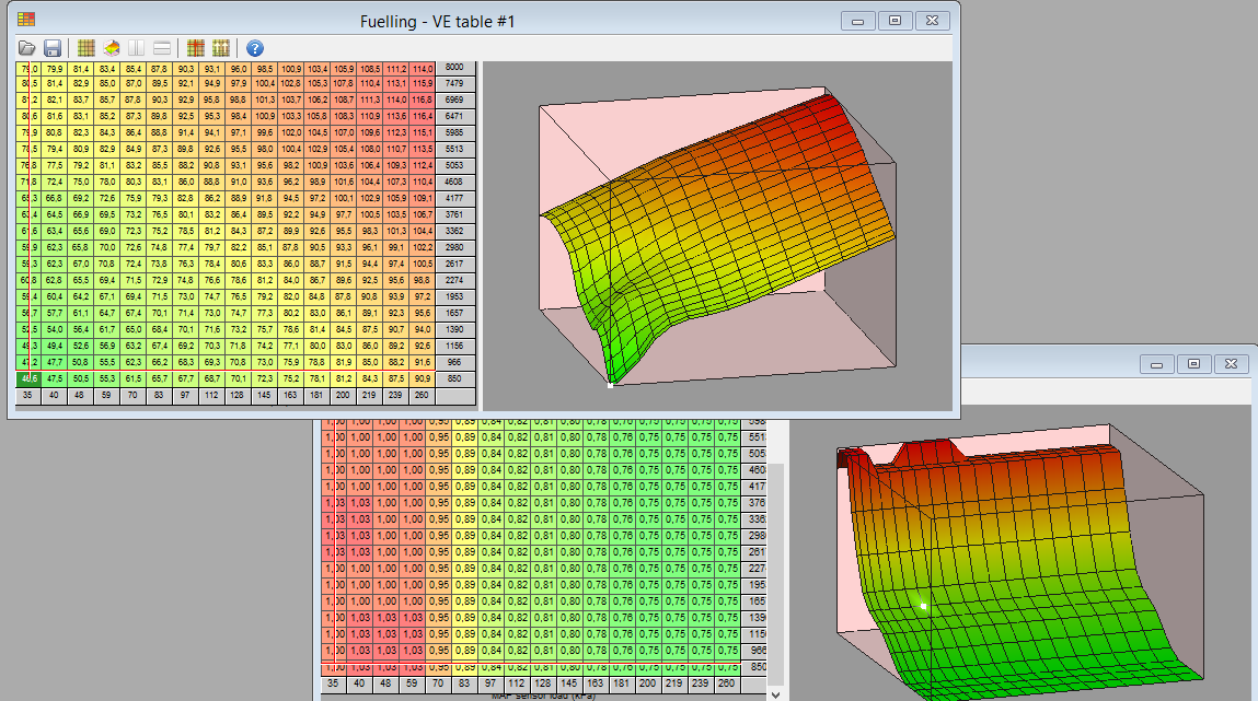

this is what my maps look right now, and car has pretty solid Idle (hours and hours of tail-chasing tuning!!! no stable idle -> no good tune possible -> no stable idle -> ...)
SR20DET with 260° in and STD exh. camshaft, pretty much finished tuning up to 0,4 bar of boost, without NVCS, idling at 900 RPM & 46 kPa:

Mi car also its 3sgte rev 3. I attached my ve, afr and ignition map. Runs a little lean but I'm sure that is better than you and hope you find useful.
