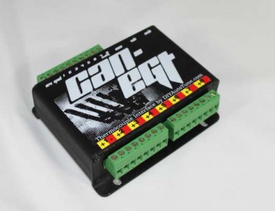

I was thinking more along the lines of a "Can-EGT" This uses Innovate data stream and has 0-5v outputs for each thermocouple so has universal appeal. If I was going to the trouble of making such a device I'd put some extra analogue inputs on it and maybe a map sensor too
