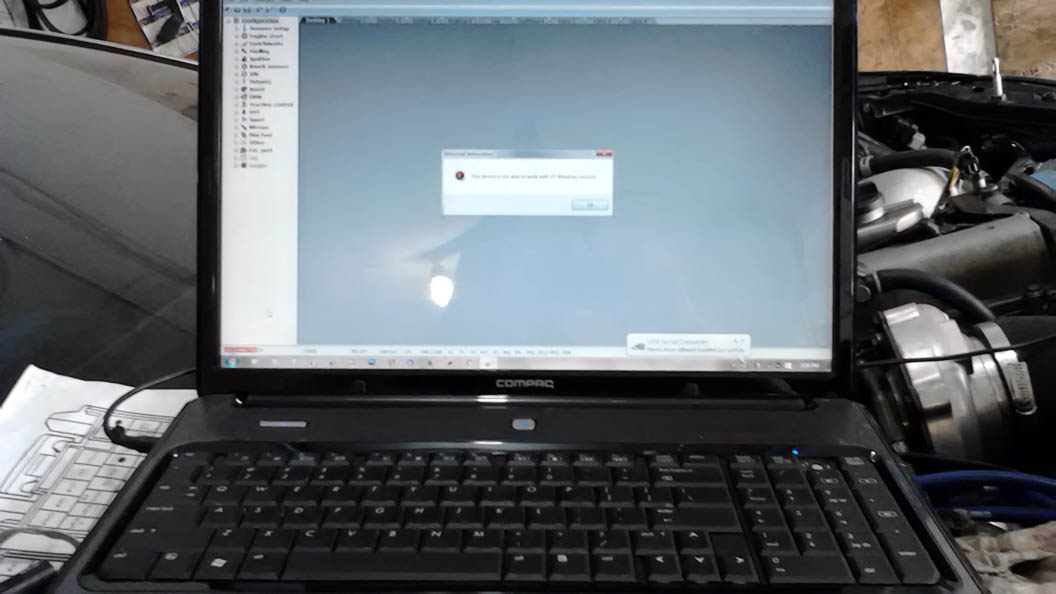

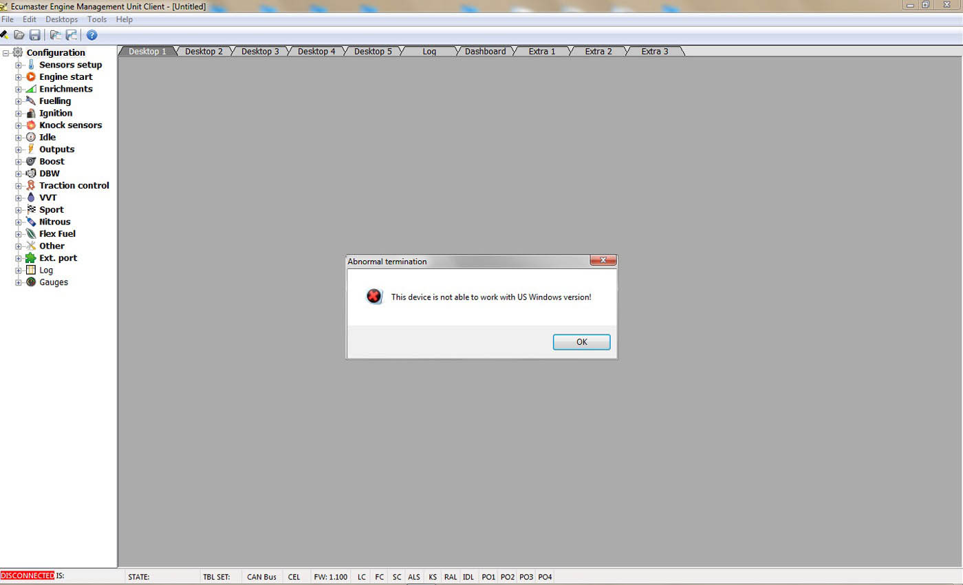

Post by Deni Dermawan » Thu Aug 20, 2015 2:29 pm
Dear gregpe,
I installed "CDM v2.12.06" on Windows 10 64 bit.
Device detected/found.
But it shows "This device is not able to work with US Windows version!"
Try to install "CDM v2.12.00".
Display "This device is not able to work with US Windows version!"
I switch to old laptop, Windows 7 32 bit Pro.
First I do not install "CDM v2.12.06".
Device (ECUMASTER) undetcted.
Then install "CDM v2.12.06".
Device detected/found but it shows "This device is not able to work with US Windows version!"
Same message appears by installing "CDM v2.12.00".
How to solve this problem?
I enclose screen shot from both laptops.
Cheers

Post by Deni Dermawan » Thu Aug 20, 2015 3:48 pm

Post by Deni Dermawan » Fri Aug 21, 2015 2:32 pm
Dear Vortex,
Today We change Windows language to Polish, Spanish, German, not working.
We change Windows region, not working.
We update "machineInfo.dat" given by ECUMASTER
Message still appear "This device is not able to work with US Windows version!".
We try a laptop from Singapore market (Windows 7 64 bit).
Not working.
Cheers
Deni Dermawan
Posts:25
Joined:Wed Aug 19, 2015 3:14 pm
Re: Toyota Aristo JZS161 2JZGTE VVTI
Post by Deni Dermawan » Fri Aug 21, 2015 2:38 pm
I install "EMUSetup_1_1_RC1" from USA website.
The same message "This device is not able to work with US Windows version!".
Then update "machineInfo.dat", same message.
I installed "EMUSetup_1_138" given by ECUMASTER.
Anybody???????
