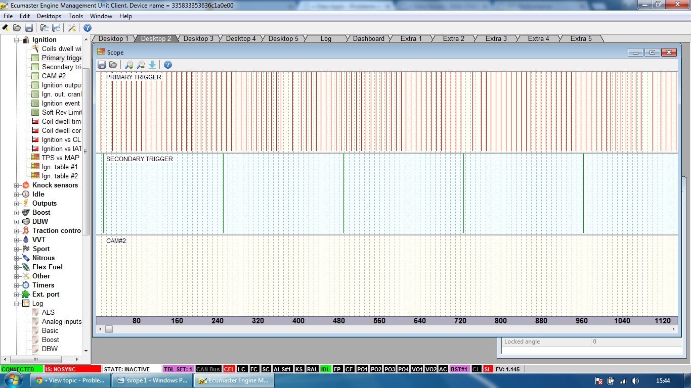

Here's a scope from this morning on cranking

Hmmm, are you sure of your sensors polarity, am just comparing your scope to a scope of mine for the same engine, and mine looks more uniform, here I attached a photo for it below, you can compare both, try to change the trigger edge for the crank sensor :) it might help, plus am using 12999 in sensitivity switch RPM in secondry trigger settings, worth the try , Good luck :)

Also it is possible that the sensors are wired up wrong as someone else done the loom for a supra and i have adapted it again for my is200. I pulled the loom off yesterday and found that there were some sensors wired in wrong places and neither knock sensors were connected either. I will check polarities on the cam and crank sensor. I also tried rising or falling and didnt seem to change anything.

At the moment i have pulled the loom out a redone most of it and tidied up cables, the crank and cam sensor wiring is correct from what i can see. But i i have noticed someone has wired in a resistor inbetween the signal output and ground for both sensors.. is this normal?

on further investigation, i have determined all of the wiring is correct, its seems to be the emu that isnt putting out a signal on ignition coil #2 G16, or Coil #5 B8 I have also tried #6 G1 and #4 G16 and have tried different wires each time with same result #1 and #3 output a signal 2 4 5 6 dont.

edit: i would remove the resistors on the cam and crank sensors and try reversing the edge3 on the crank trigger it looks from the scope to be wrong, since the first gap after the missing tooth is slightly larger than the others!!

Post by tommyboyblitz » Sat Sep 26, 2015 4:47 pm
Resistors removed, how does it looks?
Also rising cranks makes it really bad so put it back... see attached
Falling Crank without resistors.. Better?
edit- no change on ignition outputs, what the cheapest place to buy another emu?

Post by gregpe » Sat Sep 26, 2015 4:54 pm
hi
second look lot better so this is correct setup.
resistors often help with noise from sensors so is good to check if in your car they help ..
also first scope with resistor is ok..
