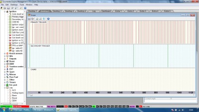

Here's a scope from this morning on cranking
- scope_2015920_958.emuscp
- (515Bytes)Downloaded 107 times
Lexus IS200 Sport with 1JZ GTE vvti

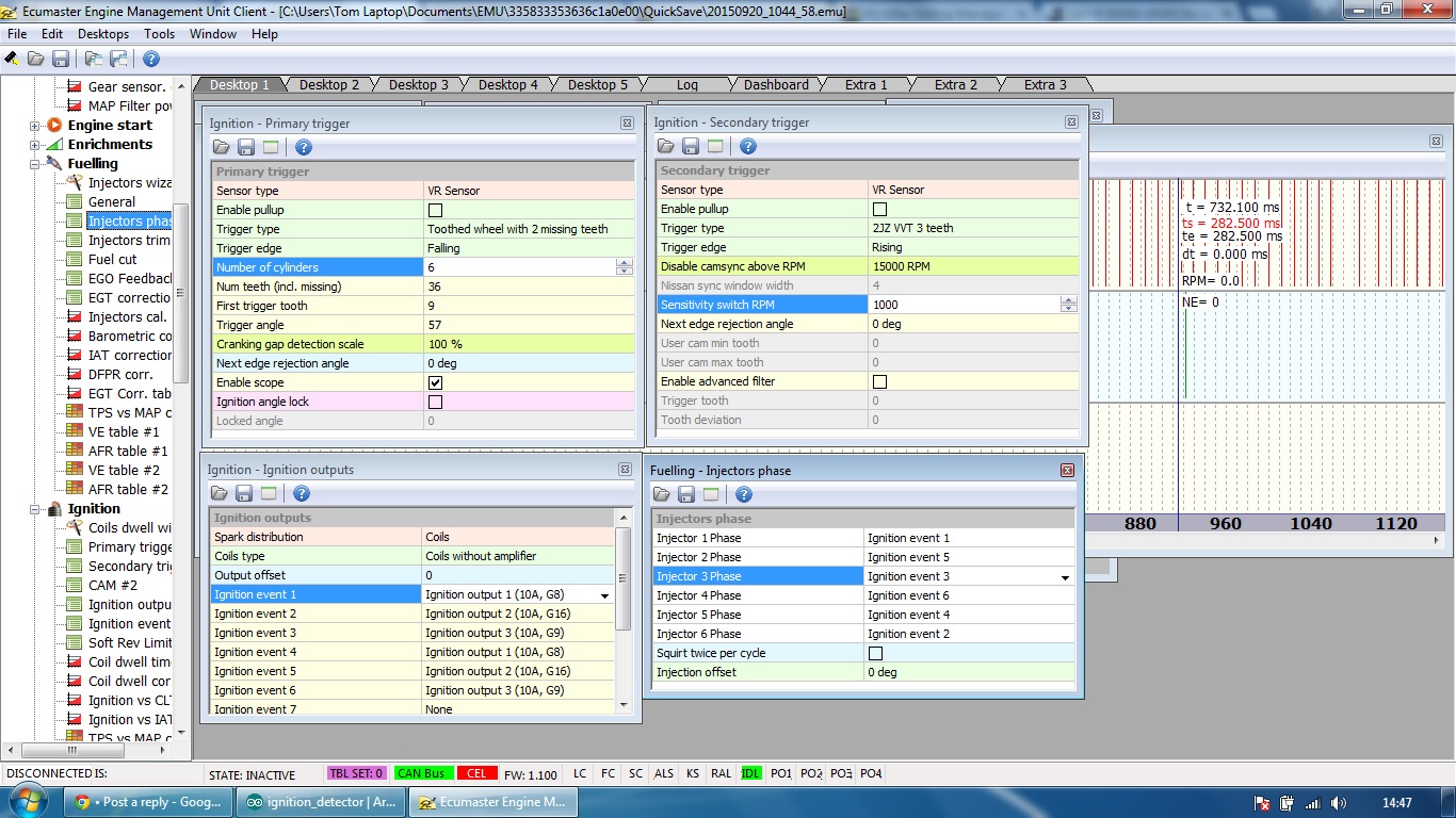

ok sure thing... this is how it is now, i have tried various orders and settings for the ignition events. I got the base map file from here for the 1jz non vvti and just adapted it for vvti.
Is there anything else you need?

base settings etc
- 1jz 1 dl.emu
- (78.58KiB)Downloaded 134 times

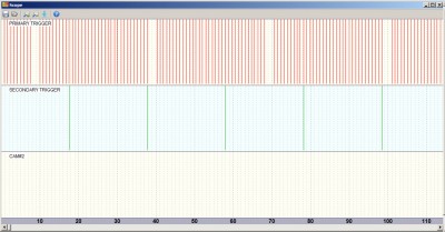

Hmmm, are you sure of your sensors polarity, am just comparing your scope to a scope of mine for the same engine, and mine looks more uniform, here I attached a photo for it below, you can compare both, try to change the trigger edge for the crank sensor
it might help, plus am using 12999 in sensitivity switch RPM in secondry trigger settings, worth the try , Good luck

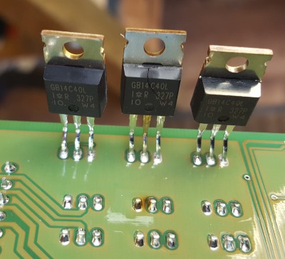

on further investigation, i have determined all of the wiring is correct, its seems to be the emu that isnt putting out a signal on ignition coil #2 G16, or Coil #5 B8 I have also tried #6 G1 and #4 G16 and have tried different wires each time with same result #1 and #3 output a signal 2 4 5 6 dont.
Also signal from #1 and #3 seem to be good and consistent now.

I like using a separate relay straight from the battery junction if you can, you want the best spark possible, you can activate the relay off the fuel pump relay works well then you only have power to the coils when the engine is turning.
The IG OPs can get damaged, we fried one once with incorrect wiring and settings but lucky we also were using wast spark and had spare ones to use.
Try updating the firmware or downgrading to an early version and back again, and double check your not using old or fowled plugs!

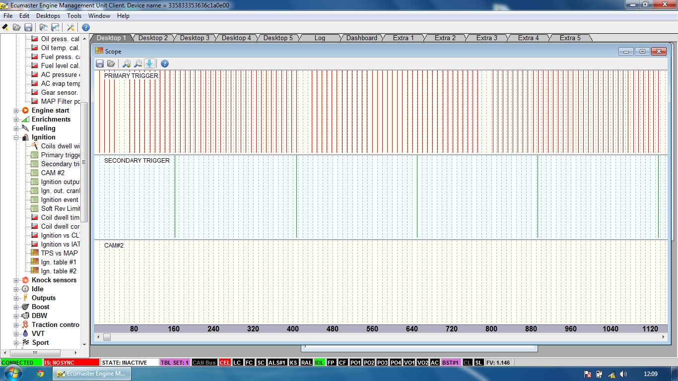

edit: i would remove the resistors on the cam and crank sensors and try reversing the edge3 on the crank trigger it looks from the scope to be wrong, since the first gap after the missing tooth is slightly larger than the others!!

Thanks, you to be honest i think this one might be fried. Was there any repair on it?
Ive tested plugs and coils etc and they all work fine, well except one coil but i have ordered a new one, the problem is on the signal pulse from the op on the emu, i am testing it directly from the emu to see if i am getting a signal using an arduino set up to test all the out puts (3 at a time) and i am only getting outputs from 1 and 3, there others dont produce a signal in any situation or combination etc.
I will try the firmware thing.
Also was there any visual damage the the emu board with the bad ops?

Resistors removed, how does it looks?
Also rising cranks makes it really bad so put it back... see attached

Falling Crank without resistors.. Better?
edit- no change on ignition outputs, what the cheapest place to buy another emu?

Re: Problems with ignition firing
hi
second look lot better so this is correct setup.
resistors often help with noise from sensors so is good to check if in your car they help ..
also first scope with resistor is ok..
