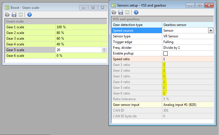

Thank your your help. I just hit one snag. How can you set the value for the gear. For exampe 2v= 3rd gear. As you can see in the picture it is greyed out, so I can not change the value.RHD wrote:There is a gear sensor input setting in the VSS and gear sensor setup you need to select one of the analog inputs, then connect a pull up resistor to power and a string of voltage divider resistors so that you get a graduated voltage signal from 0 to 5v for each boost setting you want ie 0, 1v, 2v, 3v, 4v, etc. then there is a gear calibration table that you can set the voltages to represent gears 0v=1, 1v=2, 2v=3 etc...

There's a table for gear vs volts.

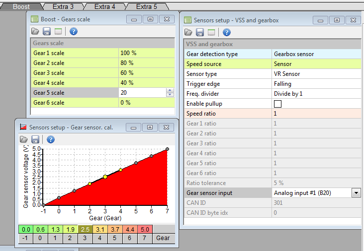

You guys are awesome. This will work perfect. I wish it had a max boost x ethanol content from preventing a user from selecting the highest boost setting while on pump gas. Maybe that can be a future enhancement.Kurt wrote:There's a table for gear vs volts.
Here is what you need in case somebody in the future was curious about how to set it up:
