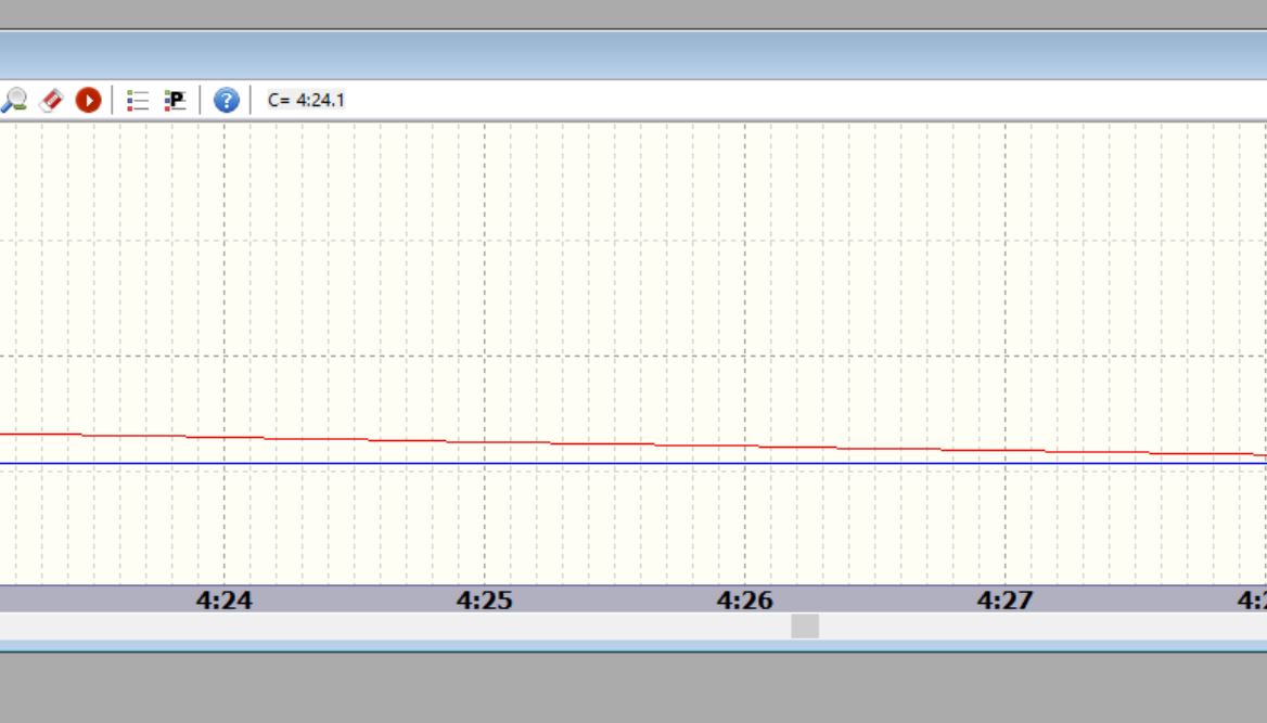

Just started to get into the ECU and have an "on the bench" test rig to allow me to make some adjustments without an engine running.
I'm using the Graph Log 1 and see the sample rate is 0.1 of a second. Its there a way to change the sample rate to 0.01 of a second?

No way. The sampling resolution is 20Hz

I'm sorry I was not clear enough, I meant the data shown is in 0.1 seconds. Not the actual sample rate.
This excel file shows the 0.1 cell change.
This screen capture shows the graph at 4 minutes and 24 then 25 seconds and so on. The light coloured lines show the divisions in 0.1 of a second.
As you can see from the excel file the time stamp is 0.1 second. I was asking if this could be increased to 0.01 second.
However as you have said the sample rate is 20hz (0.05) then that's the best data shown rate it could be.
So I ask can the "shown rate" be 0.05 to match the "sample rate"?

After separating out the Data it's even more clear what I mean.
You can clearly see the time is in 0.1 seconds.
