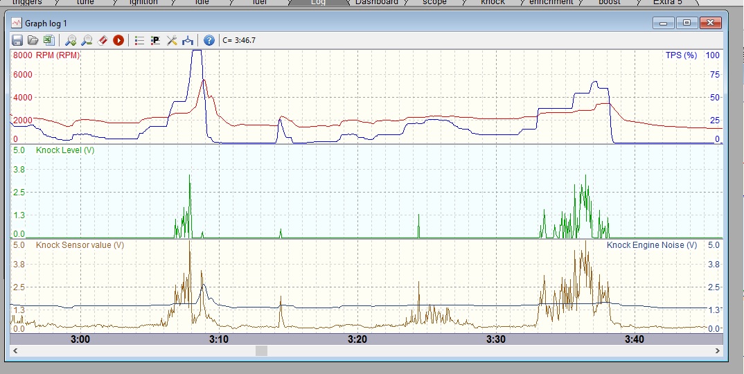

1st, go to the Log tab and open up one of your "Graph"". Before you begin driving, you will want to go back to your Knock Sensor Parameters and set up a few things. First turn your Gain to the highest setting (2.0) and turn your Integrator to 100ms (more on this later).
Now you're going to want to log your RPM, Knock Sensor Voltage, and you'll want to drive normally and make sure you are getting knock voltages. This ensures that the knock sensor(s) are working.
So I HAVE NOT made it passed this part, but hypothetically this is what I will do, and should be fine.
Slowly adjust your "Gain" setting to where you get close to 3v. You do NOT want to EXCEED this value, 3v is what the EMU sees as "normal" meaning, NOT knocking. Pretty much what I am going to do us chose the maximum amount of Gain (2) and slowly work my way down. While logging to make sure I 3v or less. Hopefully the log shows it's ABOVE 3 volts, and I can adjust the gain lower and lower. But if the knock voltage is too low, I'm not really sure what I can do.
Finally the Integrator is more or less a sensitivity dial for the knock sensor. If it's higher than it should filter out engine noise. If it's too low, it'll pick up more noise. The suggested value is 100-200ms. I personally will do the same as gain, I will start at 200 ms and just work my way down.

gain usually needs to be quite low maybe only 0.5 and set the engine noise by logging sensor value and engine noise making sure there is a good margin between them at all times when you slowly free rev the engine up close to redline. If everything is working correctly knock will show up as very large spikes

So an update. Just as RHD has said, I ended up with .50 gain. I dropped the integrator down to 150. But I am still getting ghost knock in the middle of the RPM range, but goes away in the upper end.
However, it only happens in load, so it has to be too much timing (or so I thought). I am only running 20 degrees in that area. I pulled a little bit of timing, and it's still there. I ended up adjusting the Engine Noise Table in that area, but haven't had a chance to try it.

Resonant sensors will have much higher voltage output than flat response sensors so the gain and integrator settings will be different between the two types. You will have much better knock detection with flat response sensors. I would set it up so the knock-free Knock Sensor Value gets up to around 1.0-1.2v at redline. The output range of the conditioning chip is 0-5v and you'll want to have knock events register in that range. Setting the gain and integrator so the knock-free the value is 3v will clip the output when there is a ping so the EMU can't see intensity of knock.
