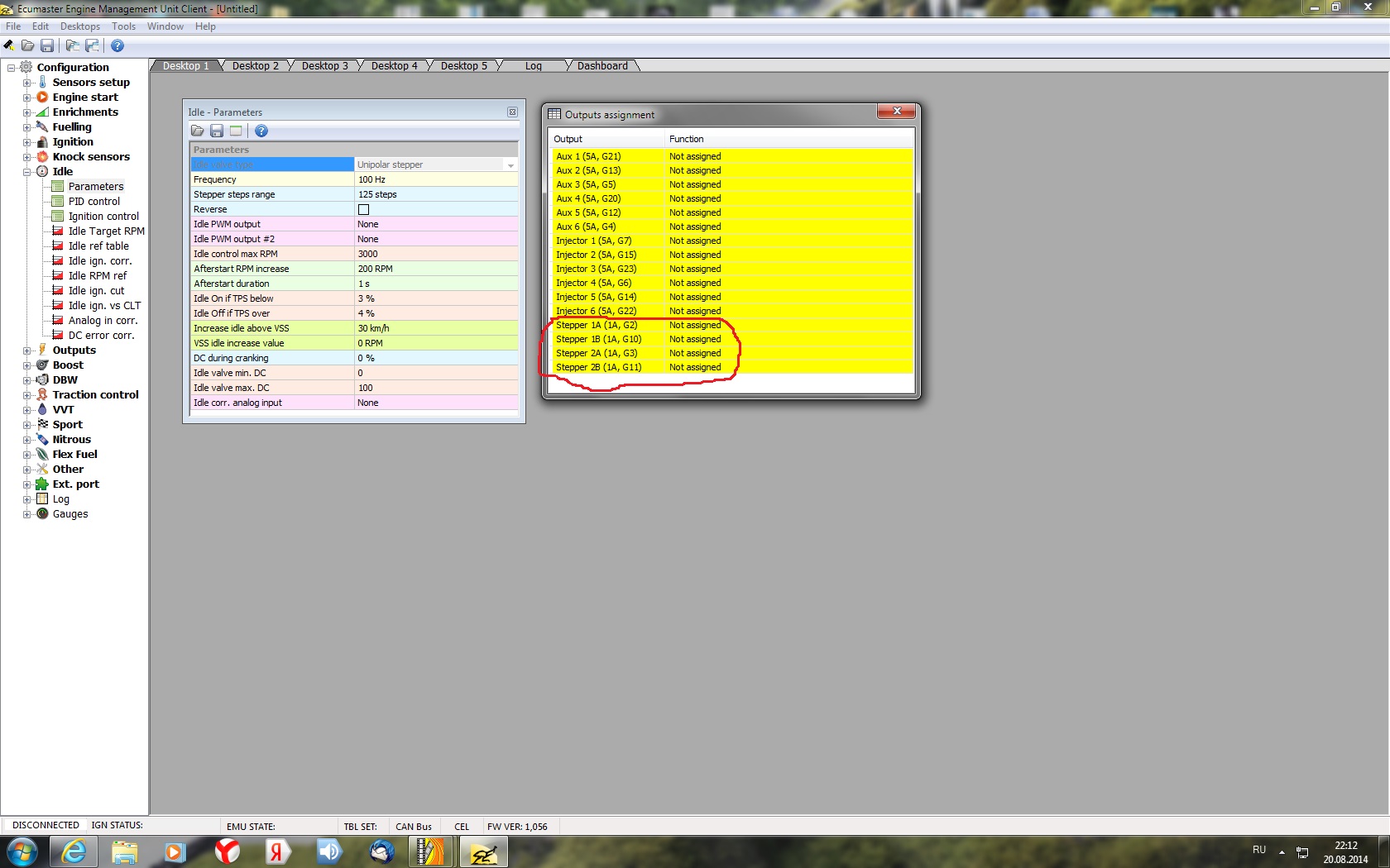

Post by lom51 » Wed Aug 20, 2014 3:43 pm
Idle-Parametrs-unipolar stepper - not active...
Re: idle valve 2JZ-GTE
Post by PSI-Motor » Wed Aug 20, 2014 4:04 pm
Close down the idle parameter view to the left in the picture and open it again then it should go active.

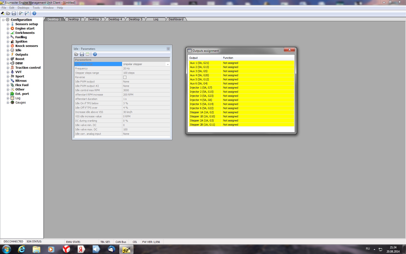

Post by lom51 » Wed Aug 20, 2014 4:19 pm
Ok, thanks!
Now outputs - "not assignet" and stepper not working...
Post by Jadzwin » Wed Aug 20, 2014 4:47 pm
Hi!
Please check if there is idle control active 1 on the log or in idle log group window.
Your configuration seems to be ok. The fact that there is no assigned outputs in assigned outputs window is a bug (outputs are assigned for sure, bug is already fixed).
