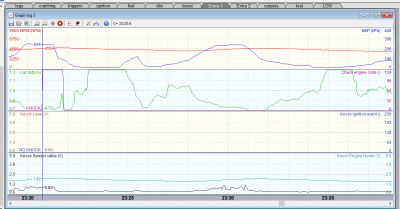

Here is a graph when the check engine light came on. I thought it was knock at first but the knock sensor input is saying otherwise. I am still working on the ve map that's why the lambda is off.
Re: Check engine light is too sensitive to knock output
You are right, it should't throw knock code with that sensor level, either is a bug or some spike of voltage not shown on log.
