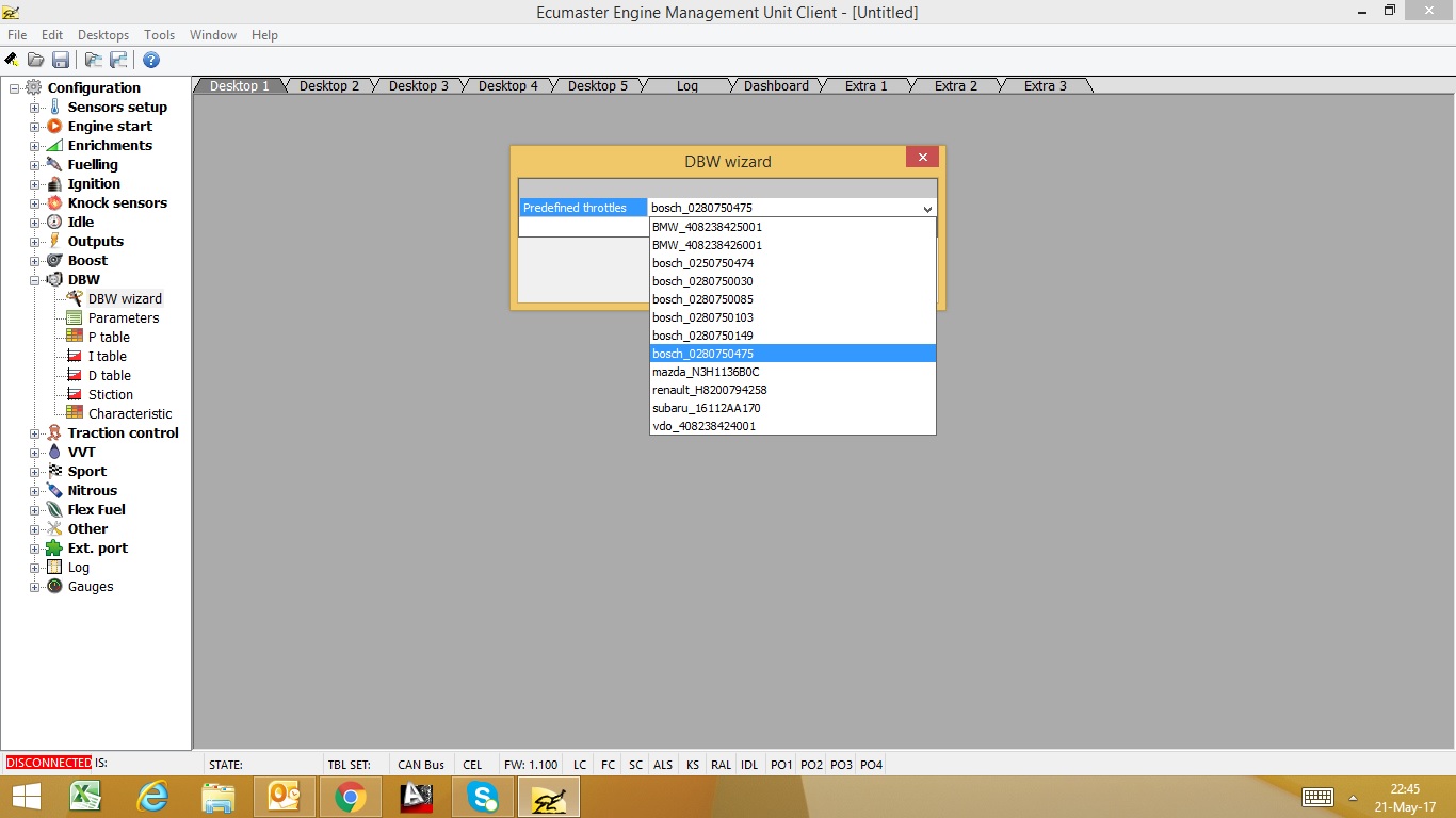

yes i did ... looks to work very good with similar Porsche DBW calibration included in EMU software already
Re: Throttle body bosch 0280750474 calibration
Hi, there is another version of software? because in the last one i have downloaded, there is no calibration for 0280750474...Karel wrote:yes i did ... looks to work very good with similar Porsche DBW calibration included in EMU software already
