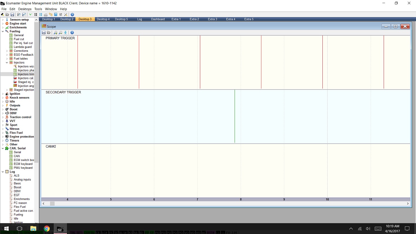

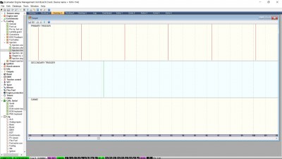

Some additional Info..
The cam trigger is right where it should be directly in between 2 primary triggers, but when I rev it, it moves a little.
Seems like this COULD be normal with a timing belt motor because of belt deflection/stretch but unsure. The motor has a brand new gates racing belt on it, thats hard as a rock, so I'm not really sure that its stretching...
This image is at idle.
This image is off idle, maybe around 3k rpm
The timing is pretty consistently off 5 degrees when reving it off idle, it doesn't seem to fluctuate or change any more or less than that.
