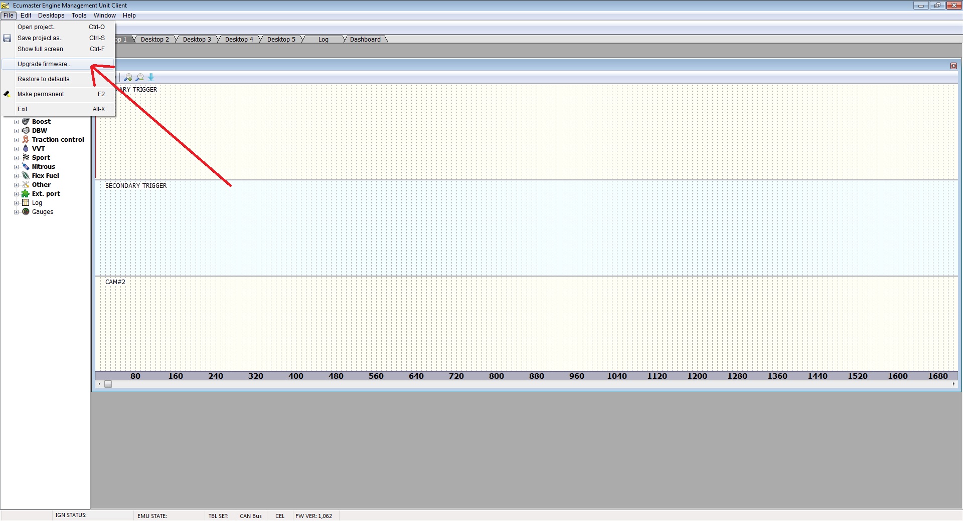

Hi, i've installed the new version of the software 1.062 but when i connect the ecu, automatically the software 1.016 was open. What is the problem?

you have to upgrade the firmware of the EMU itself. Seen on the picture or in the manual
