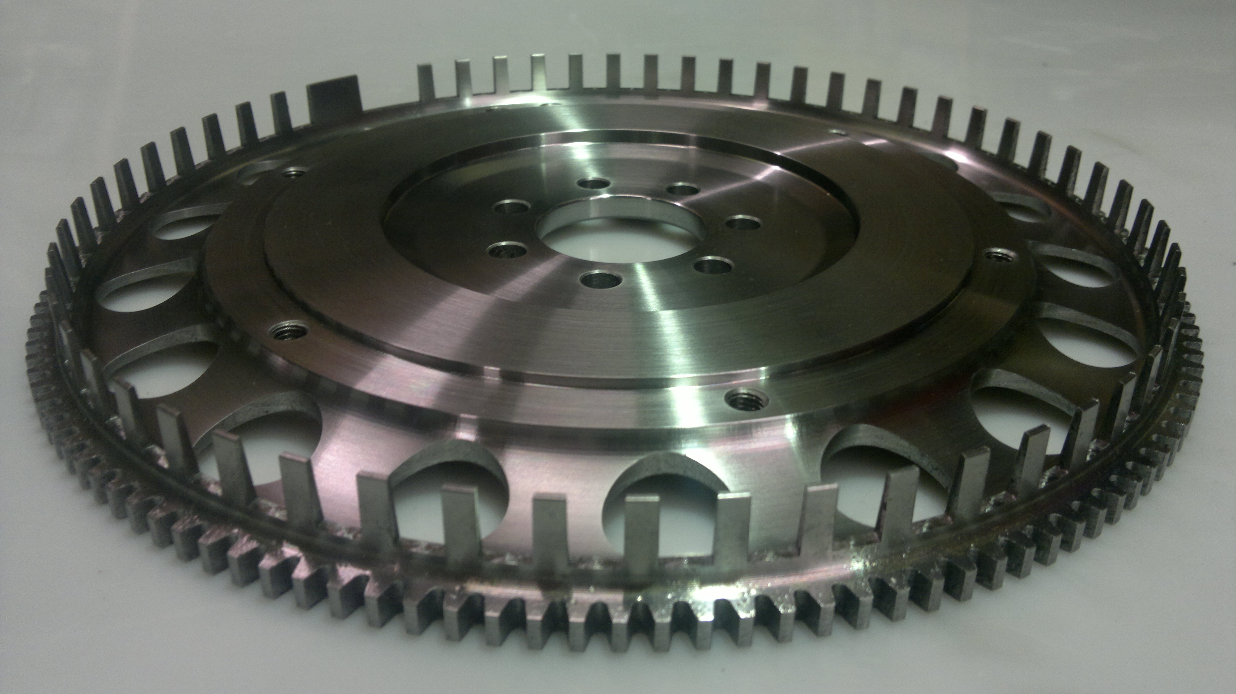

I have mount EMU Black on Renault, but i can't start engine, i don't know trigger Wheel setup
how know good setup ?
Thanks for your help
Fab
Re: EMU BLACK ON Renault
Post by Karel » Sat Jun 02, 2018 7:28 pm
If you knowledge is so bad like your post is.... there is no way to help you.
What model of Renault ? DO you have better photo then just 5 tooths of the flywheel ?

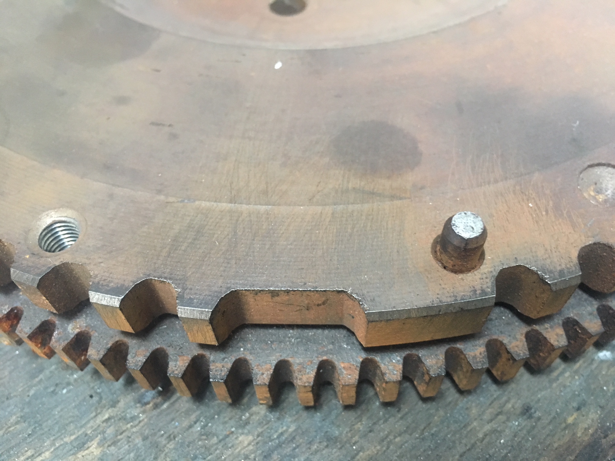

Emu black was wired on Renault Clio 3 RS, flywheel is mount on engine , I haven’t photo, all latest Renault have the same flywheel 60 tooth, I have found this photo
Let me know
Thank for your help
Post by Karel » Sun Jun 03, 2018 9:33 pm
then this will be 60-2

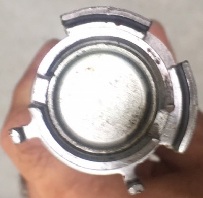

thanks, now engine start Wheel but i can't read camsyn , here my trigger cams. read signal fail.
it's 12v hall sensor but internal pullup do it it with 5V ?

the cams teeth
