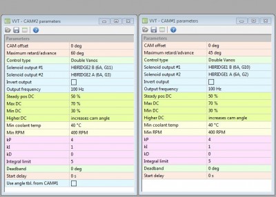

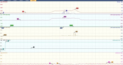

Howdy all,
Just wondering if anyone is able to help with VANOS DC, freq etc settings, as my exhaust cam target is showing -377° from target and Intake cam -84°from target as per below - Intake is CAM#2 and exhaust CAM#1 (N+1). Just to speed up the process a bit as it took longer than anticipated in the limited spare time i had available to get the rest of the basics sorted :lol:
